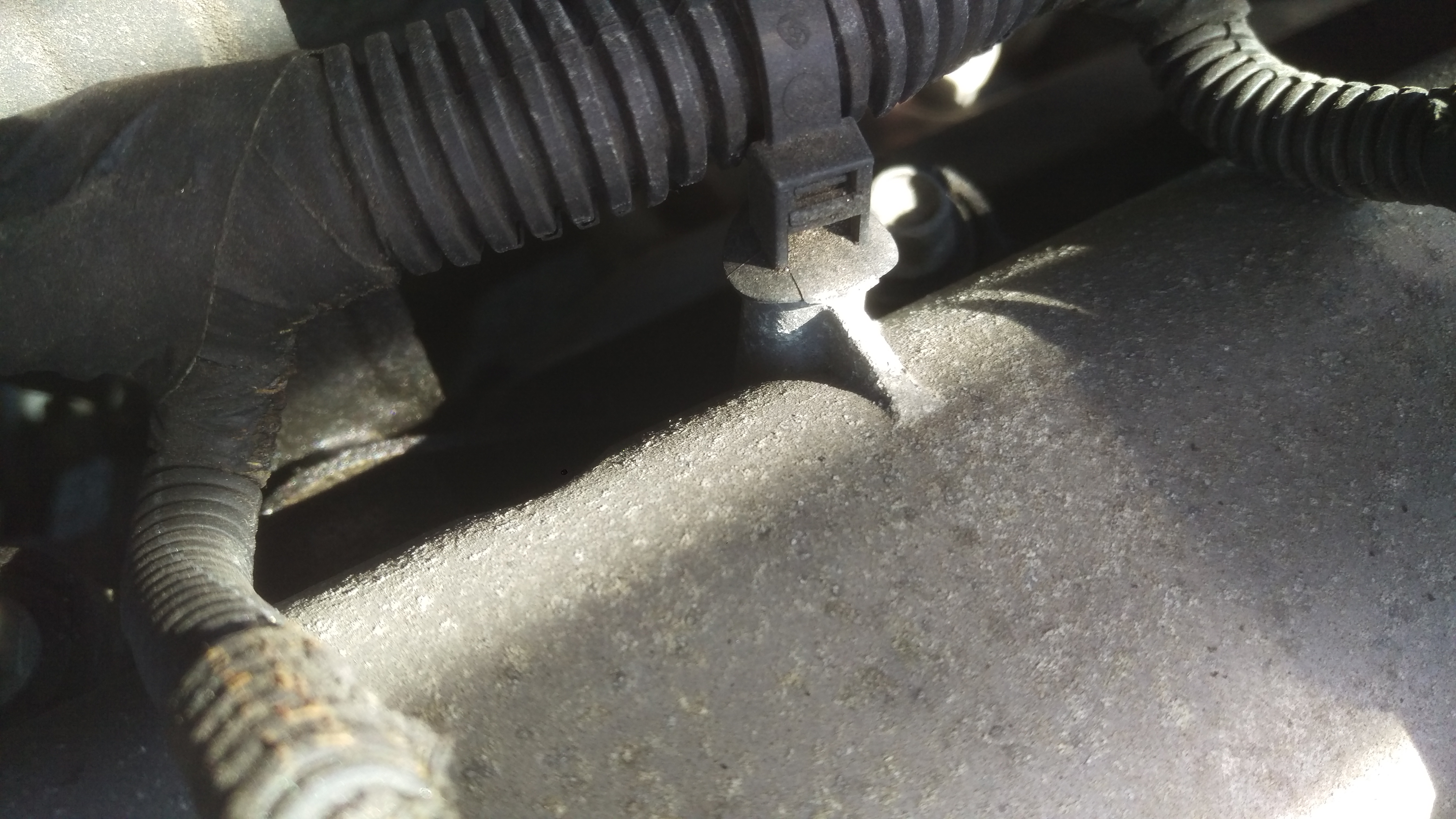

from the top:

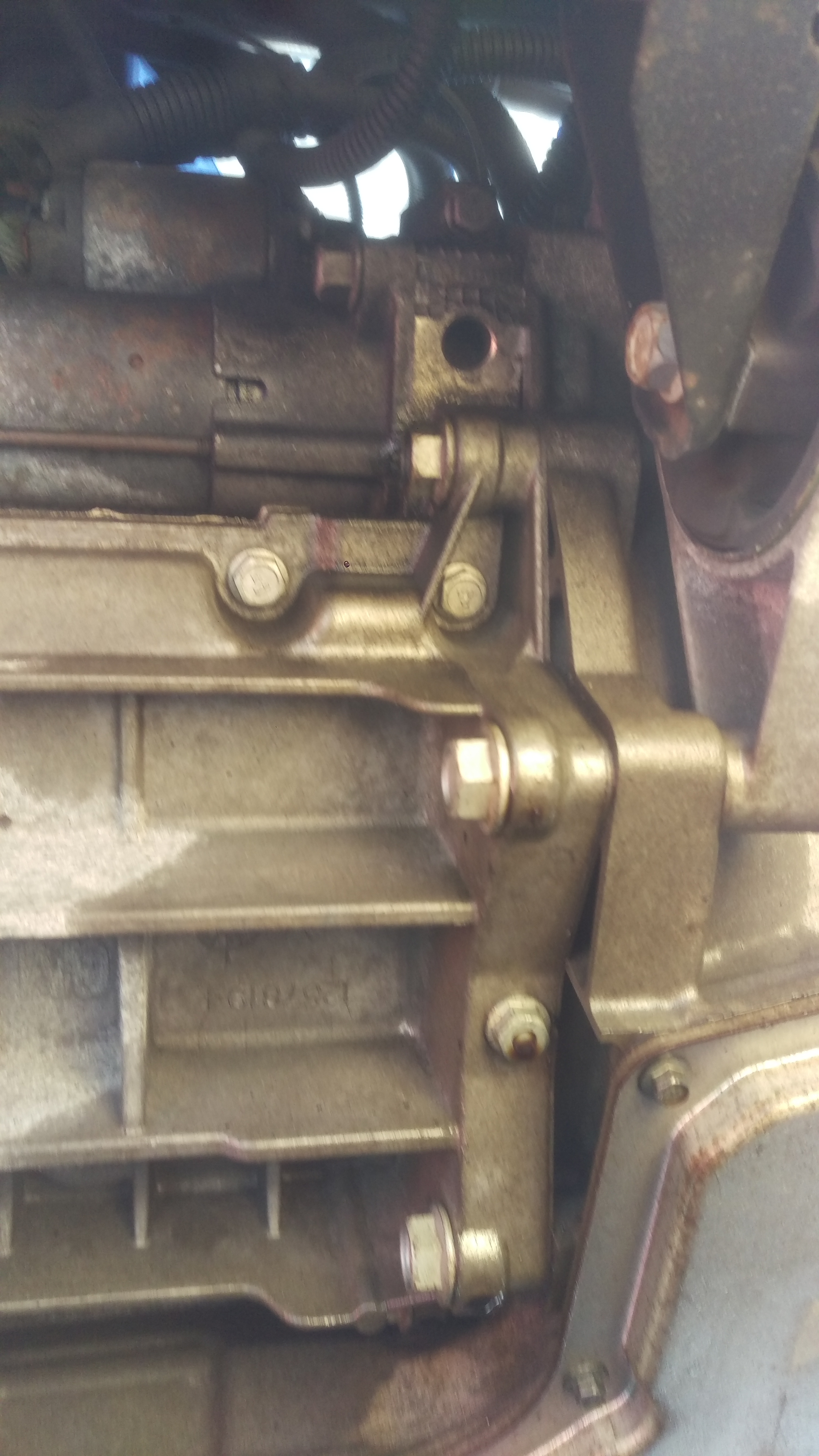

from under the engine at the connection to the tranny:

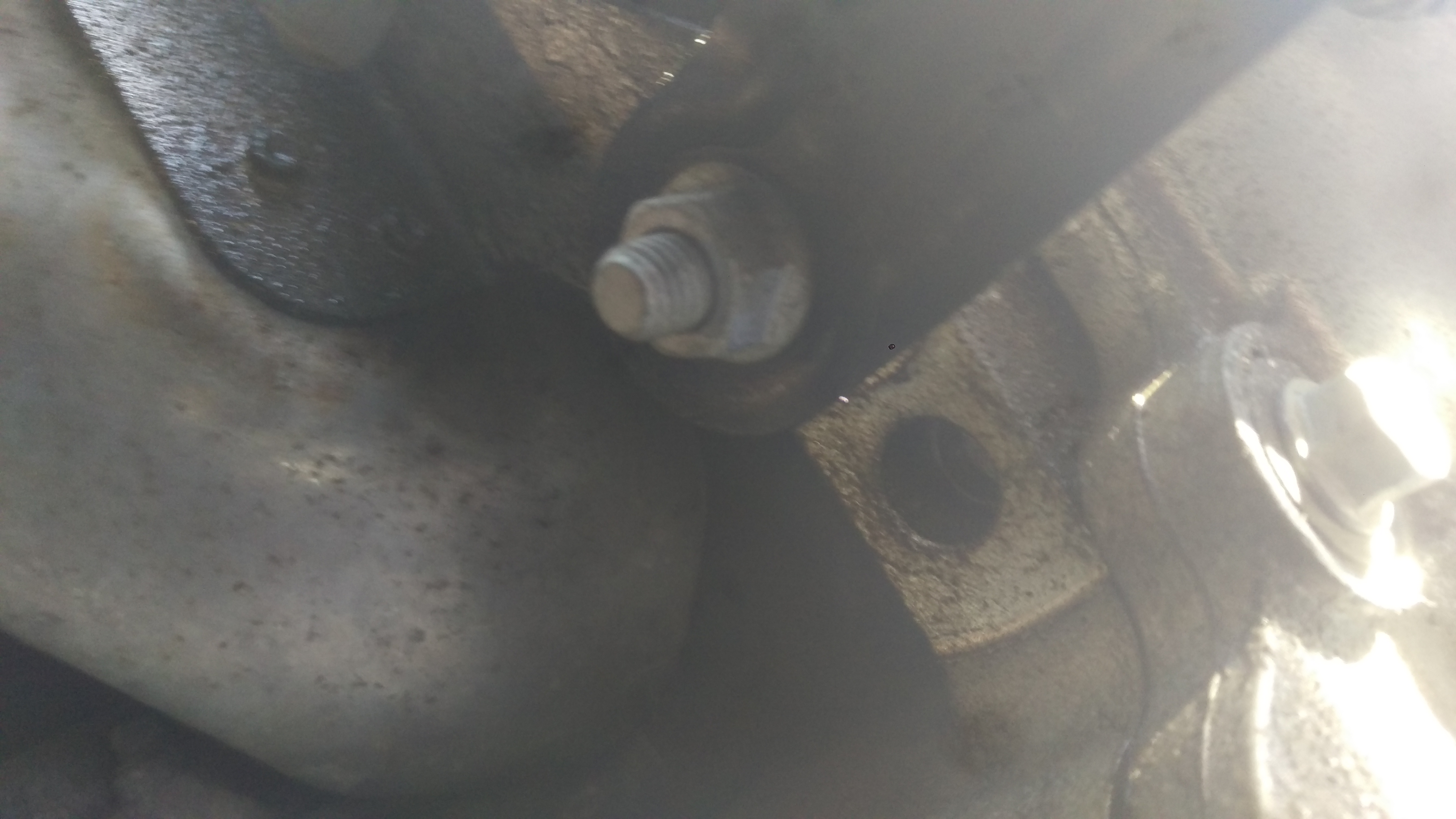

by the starter:

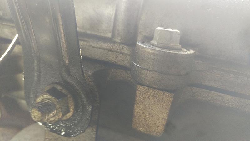

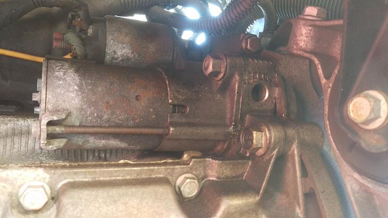

back of the engine:
what do you people think??
it seems more of a leak then just the cam cover. is there anything else that this engine is prone to leak from??

I'd check the oil pressure sending unit it's just above the starter
https://www.chevyhhr.net/forums/how-...ng-unit-57962/
Old May 14, 2017 | 06:22 PM
Posts: 26,532
And the filter cover, and the person that changed the filter last may just be sloppy.
