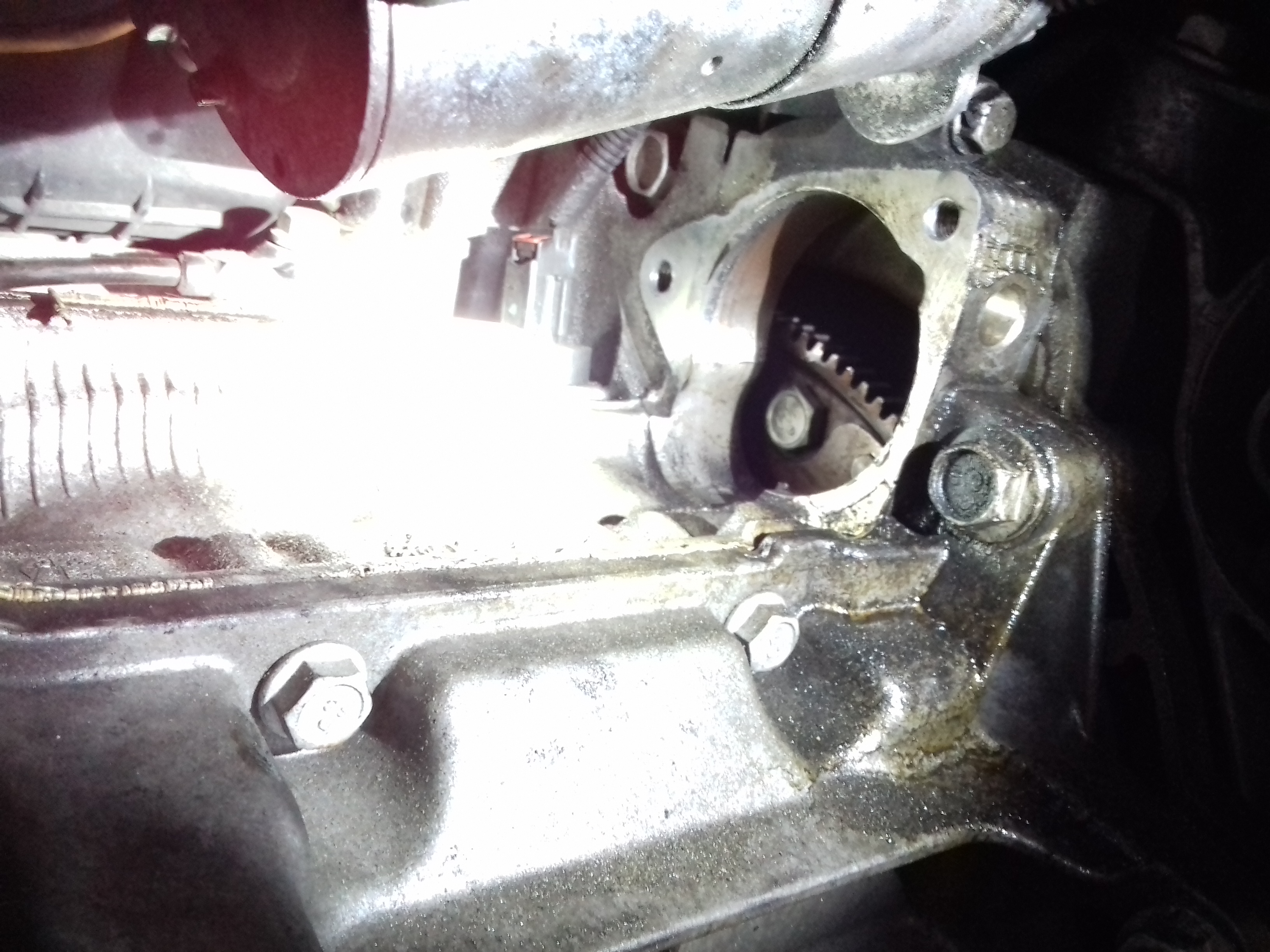

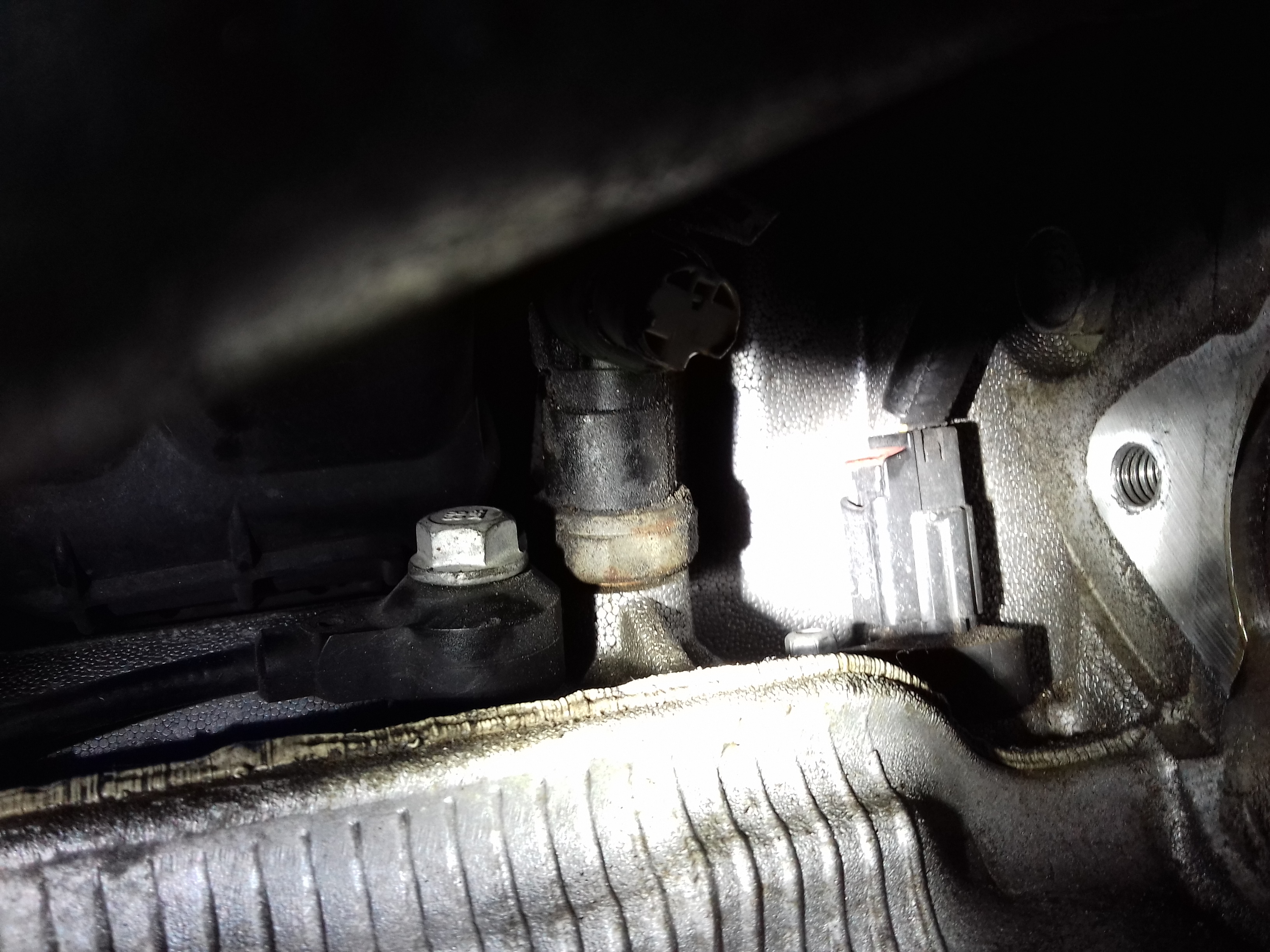

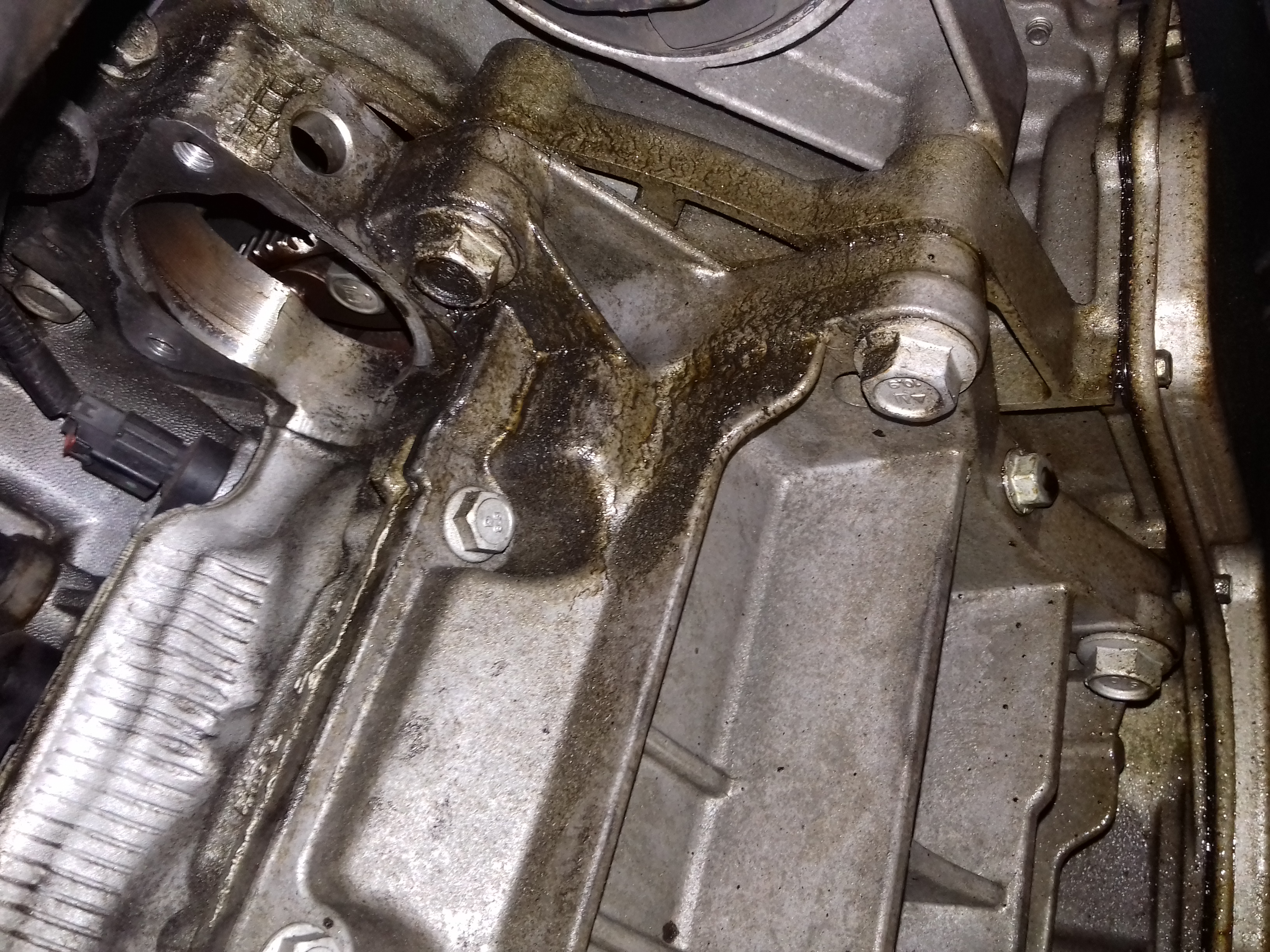

ok, took off the starter and noticed that the sending unit was dry:
looked in the hole for the starter at the flywheel was all dry:
appears to be my pan:
anything else i should check??

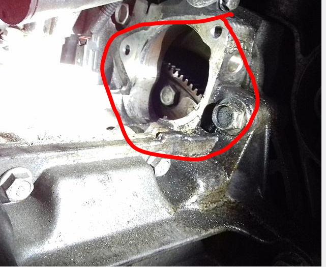

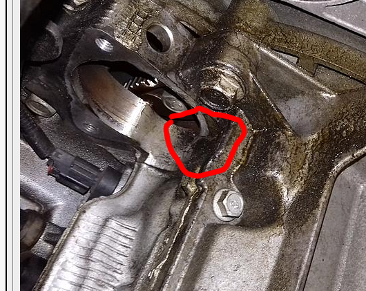

Looks like it's coming from this huge hole to me. In other words; the starter isn't mounted tight enough?

Give that area a spray of brake cleaner, and snug the pan bolts , it looks like run off from oil filter changes!

donbrew --- hmmm oil resides in the flywheel area??? those bolts were incredibly tight. i will retorque them tho.
old blue --- after the retorque or actually first i will just clean off the area. i lean towards the oil pan gasket. i will retorque those as well. the leak seems quite a bit more than over flo. is there a place on these engines for the oil from runoff to pool until it tilts/shifts??

Oil pan is relatively easy, no gasket just RTV silicone. Per

87z16 - no, oil does not reside in the flywheel area.
Old May 24, 2017 | 11:22 AM
Posts: 26,532
However, the rear main crankshaft seal does.
Old May 24, 2017 | 05:52 PM
Posts: 40,083
And oil will take up residence if the rear main starts leaking!!
