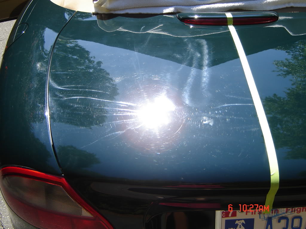

Well, I wanted to add that there is a difference between masking swirls, and removing swirls. When you glaze or wax over a swirled area, you are filling in the swirls, not removing them. Once the product washes away, the swirls return. The only effective way of removing swirls is to properly machine polish them away.

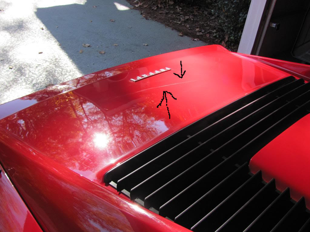

Proper machine polishing is very difficult. If done incorrectly, buffer trails are left behind, which are as unsightly as the swirls themselves. Here is an example of buffer trails on a Ferrari 308 that I recently polished. The car was previously polished incorrectly, and buffer trails were evident upon arrival...this picture of the rear deck was symbolic of the entire car when I arrived:
After properly polishing the car, here is an after:

Here, you can see buffer marks on the trunk lid of this Jag, that was improperly polished.
Here is the right side of the trunk lid, after I corrected:
