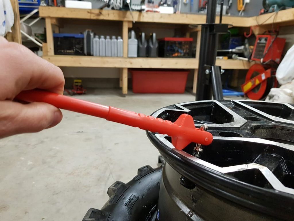

I've got the Milton valve stem puller coming in a day or two.
The brass stem the sensor fastens to isn't just a hollow tube. It would be hard to snap it off and with the sensor fastened to it, it's not going to come out very hard before it hits the rim. I think the safest way to get it out without destroying something is to remove the screw even though that's a PITA. I thought about trying to get some sidecutters on it but there's not enough room and it would take a tremendous squeeze to cut it. Using a saw would make all sorts of filings I'd rather not deal with. I don't want to risk dropping anything inside the tire and having to dismount the tire to get it out. That's why I had the rag pushed in under the sensor in my pictures. I'm trying to get by just breaking the bead and squeezing the tire enough to get at the screw and push the replacement into the hole afterwards.

Again, thanks to everyone's help here on the forum and a couple of warm days, I was able to finish replacing all the sensors yesterday, rotated the tires today and successfully complete the relearning procedure letting air out of each tire just now. All is well and the Information Center is pleased to display the correct tire pressures once again.
I used the valve stem installer to bend the valve stem over a little making access to the screws easier. I tried a little too hard on one and snapped the threads off. Even on that one, there was enough threads still showing to get the tool back on it and tilt it over. Stuffing a rag underneath where I was working keep from loosing the tools down inside the tire. By only breaking down one side and not allowing the tire to turn I'm hoping I won't need to have the tires balanced again. The tire shop I had balance them used the Hunter GSP9700 Road Force System (now called "Road Force Elite") and it was perfect. It was a one man shop and he retired - I'm going to miss him! If you want a perfectly smooth ride after purchasing tires, see who in your area has one https://www.hunter.com/find-equipment/
