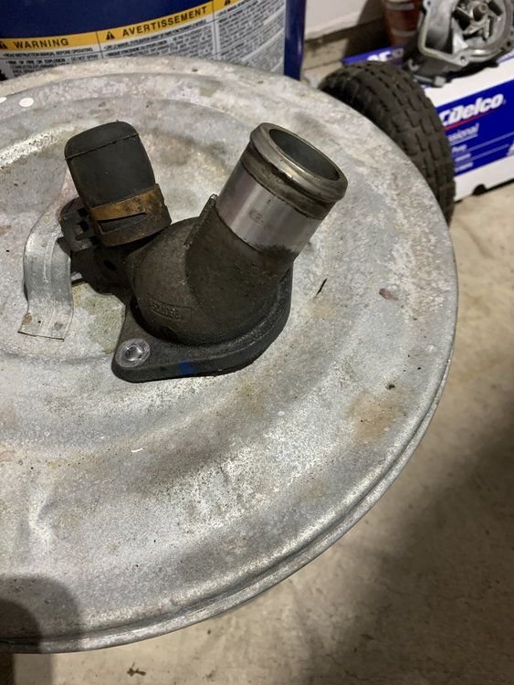

Old Jan 6, 2023 | 04:11 PM
Posts: 40,068
Yes, and tee off to the oil cooler from the thermostat housing
This hose from the thermostat housing is eliminated, the housing is replaced with a 2007
This tee is eliminated and the rad hose from a 2007 is used to replace this mess
Old Jan 6, 2023 | 04:19 PM
Posts: 40,068
This is the oil cooler style thermostat housing, this one I’d off my 2011 2.4 l , the black rubber cap can crack and leak coolant
This is the housing from a 2007 , note there is no provision for a heat hose to go to an oil cooler or get capped off and potentially leak coolant
