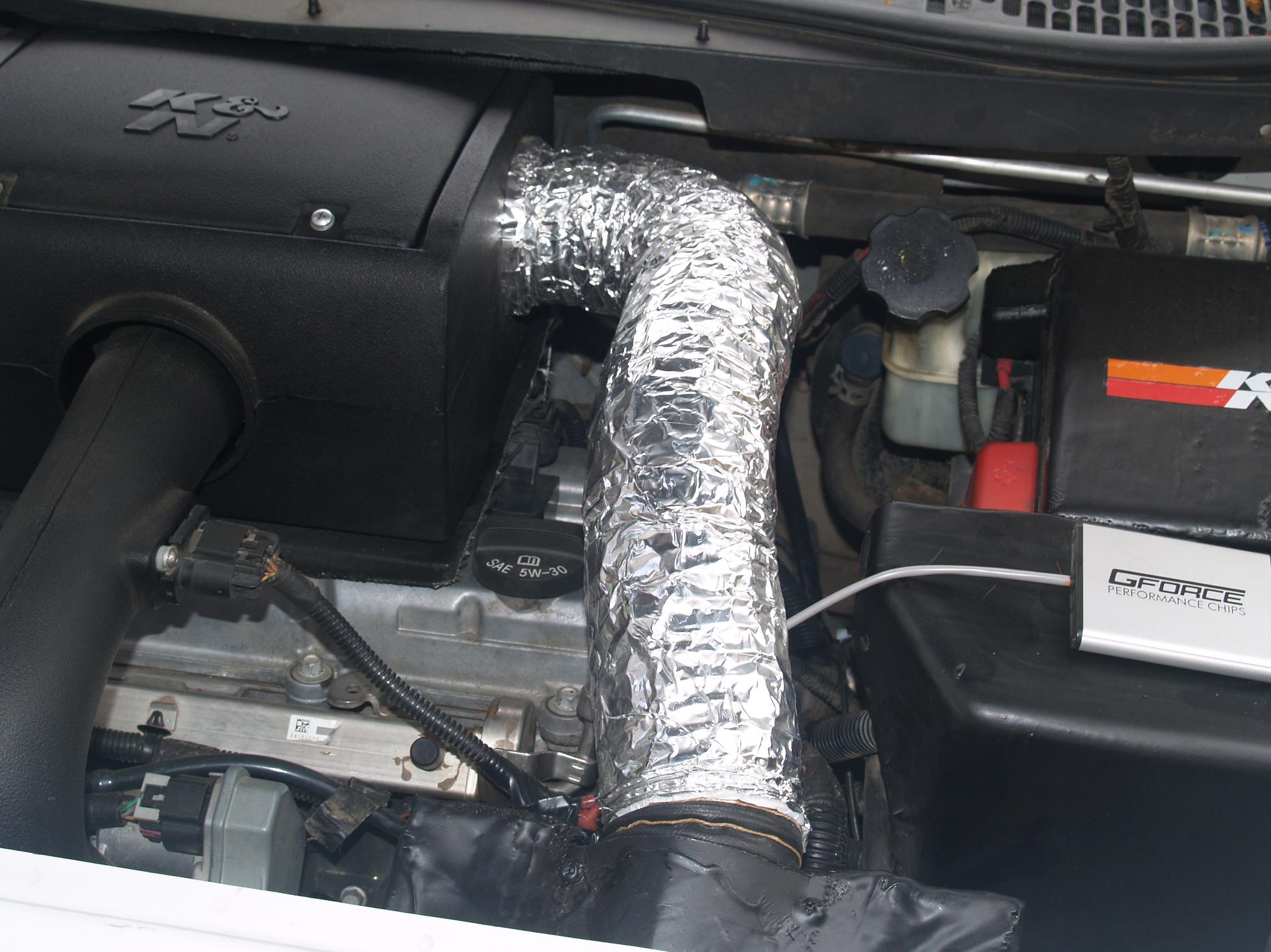

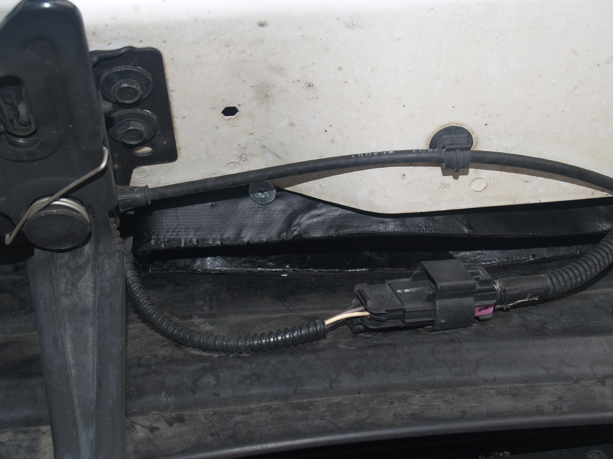

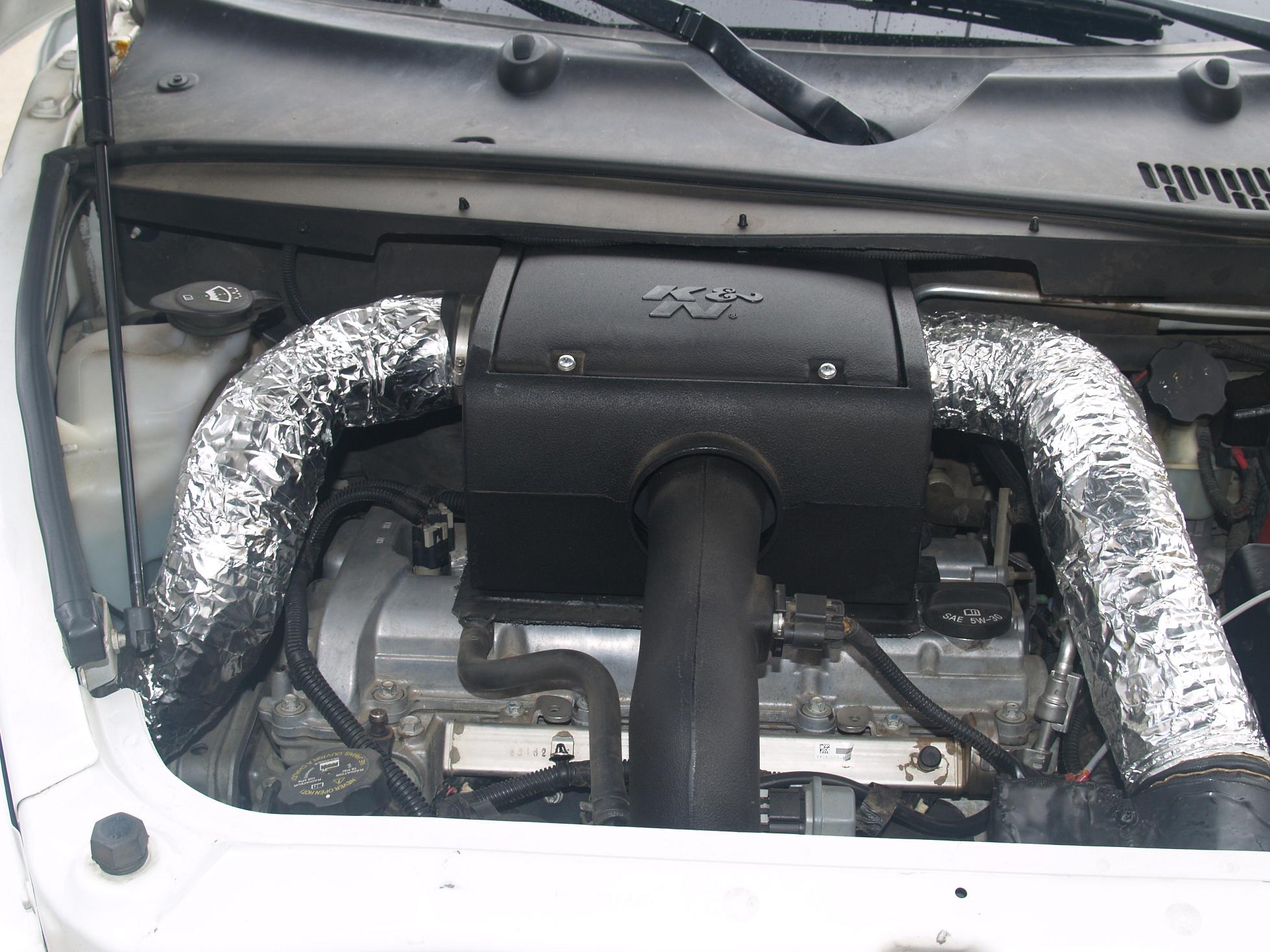

Here are 3 pictures of the intake. First shows the opening just on top of the radiator, the other 2 show the intake hoses. The silver tape is insulating/reflective tape left over from my racing days. If you look closely you will see an insulating plate under the air box made from insulating wrap that was expoxied together and it keeps the heat from the top of the engine out of the air box some.

Looks good.
