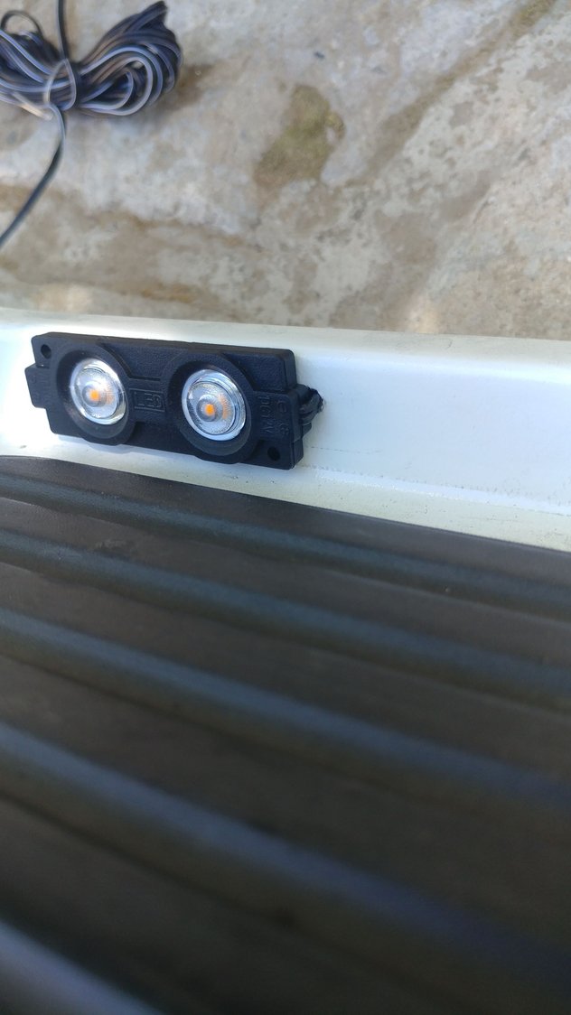

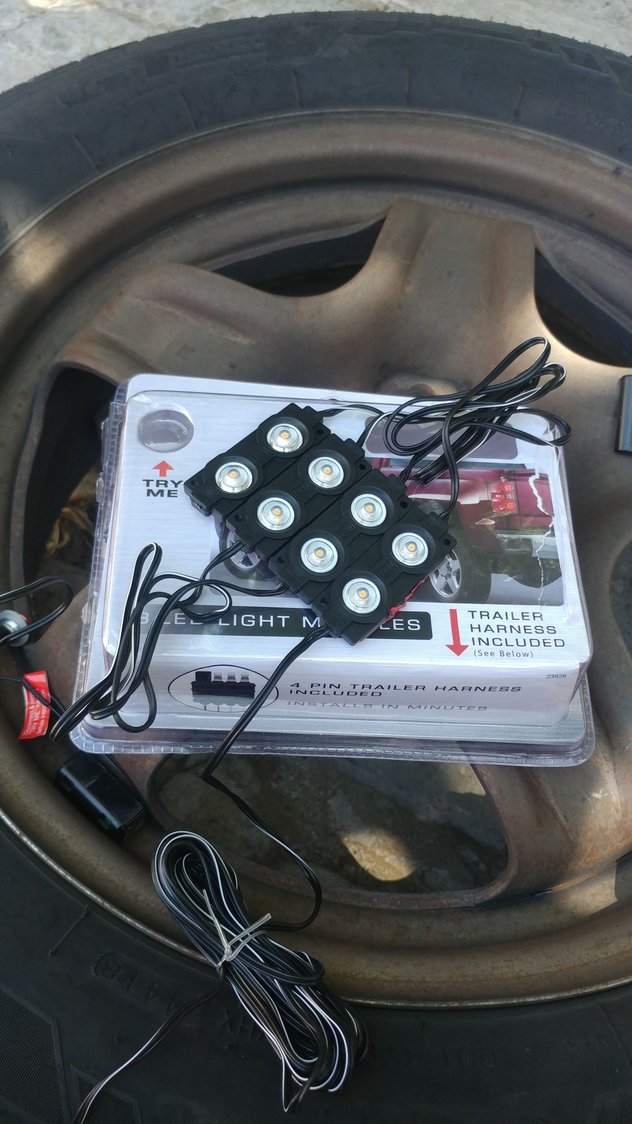

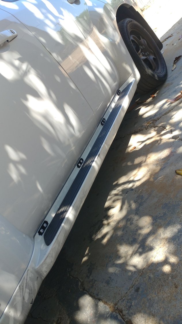

Installation was easy. Yes I did drill some small holes for the wires. I used waterproof butt connectors to reconnect them. Came out pretty good. Will have to wait a few hours for night pics.
I plan to tie them into the parking lights up front so they go on with them as well as the turn signal. Is there an easy way to do this? I have never looked at the parking wires before. If its just 2 wires, should be an easy tap? Would you use a relay on them since they don't really draw much power at all? I'm thinking even if it draws too much it will just pop a fuse, right?
