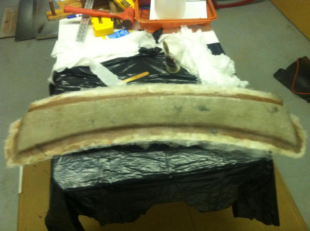

I'm working on the mold. I should have it done by this week. In order to make the mold correctly I actually had to cut into my spoiler! It should be repairable, but it will take a little work.

Quick update. I've added all the flanges I need to the spoiler yesterday. I'm heading into work tomorrow to lay the first side of the mold up. I had to use some aluminum flashing and actually cut into my spoiler to get a proper parting line.

Mold update. I didn't like how the first mold looked. I'm laying up a new one this week. Thanks.

I just pulled the top half of the mold off of the buck today and it looks great! I can't wait to make the lower half of the mold this week. I tried a new gel coat for the first layer of the mold and turned out great.
Here's a teaser picture of the mold building process.
Andy,
