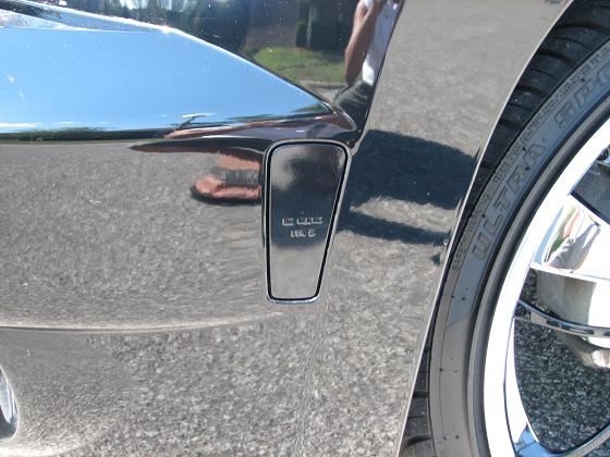

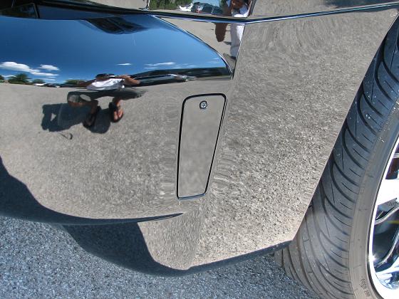

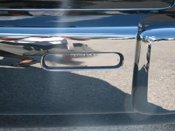

Vinyl-ed markers...
I just blacked out my reflectors and side markers last week. I went down to the vinyl shop and bought a 2x2 piece. I measured all the areas and added about 1/4 inch on all sides. Cut them out and placed them on. I used a credit card and exacto 4 the fine detailing. Then I used I needle to pop the the bubbles around the lettering on the markers. Here are some pics of them. I think they came out pretty decent, not as glossy as the paint job but it solidfies the black on her...
