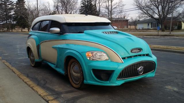

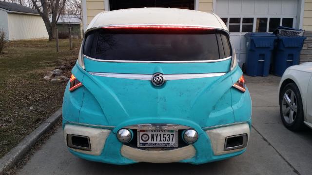

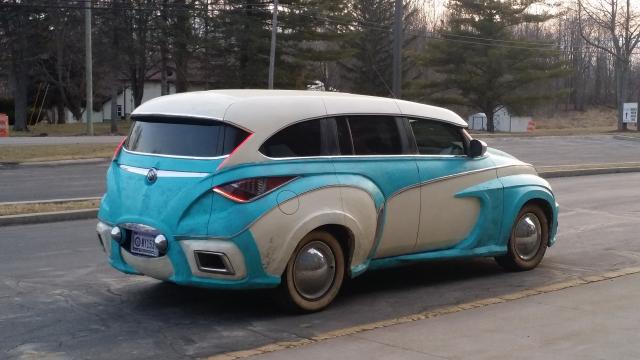

Okay, it's been a long time since I posted any progress on the Bijou and this isn't much but it's something. I have my rear pillar tail lights and third brake light plus the chrome at the belt line, around window, and across the visor and rear spoiler. It will all be sacrificial but it will help me for dialing in the fiberglass.

Looking good my friend. Glad to see the weather has broken and you can work on the car again.

We're not worthy, we're not worthy!
I kid because I've been going through Bijou withdrawals Ben.
It just keeps on getting better my friend!
