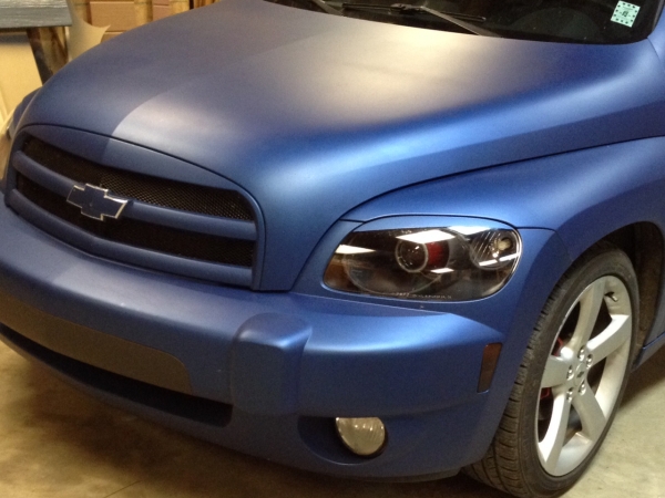

UNLESS.....you do a retro-fit with projectors. I have normal high/low beam function using projectors and HIDs inside a set of Depos using a wiring harness from The Retrofit Source (less than $30). I pulled the fuse for my DRLs under the hood and have zero issues.
Old Feb 25, 2016 | 05:45 PM
skyline26's Avatar
Joined: 08-09-2012
Posts: 1,979
^^ those lights look good man! did you do them yourself?
