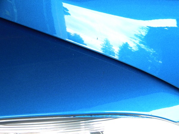

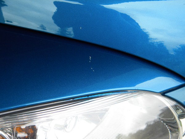

http://www.nicoclub.com/archives/dr-...ip-review.html
Its my understanding that it will color the chips to match the color of the surrounding paint. The fill and sand method is how my grandfather showed me. I could so it so well, that the only way you could tell it was filled would be if you get close up and see that the metal flake isn't perfect to the grain of the rest, that's all. Its looks best.
There was some color lacquer pen that was on TV infomercials for a while. It was called the "Fix It Pro".
Absolutely horrible. It just made the chalky white go away that comes with a scratch.
Fill, sand, rub, buff, wax. Make sure you wash it well with Dawn dish soap first and let it dry prior.
