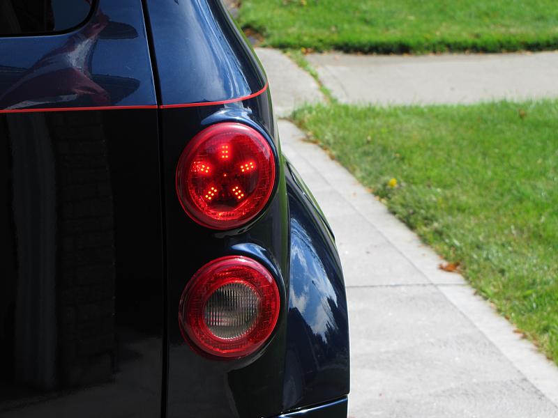

I installed LED lights too! Albeit a bit more expensive I bet... :)
Last edited by RJ_RS_SS_350; Mar 11, 2017 at 11:55 PM. Reason: added more goodness
Old Oct 23, 2016 | 11:51 AM
Posts: 40,068
Those have the resistors built into the lights, a great deal!
My spider bulbs have the same or similar set up
