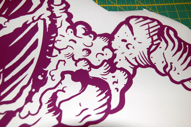

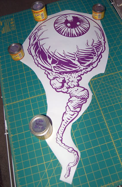

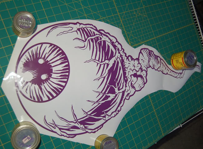

Working on this one at the moment. About 17"X29".
Weeding and leaving the little tiny details I cut is Tedious. My eyes ain't what they used to be!
"Weeding Vinyl" is pulling off everything that you don't want after the plotter cuts it all out. The B*tch is while weeding you drop or let a piece you pulled touch what you want left in place, it grabs to itself Quickly and your sometimes left recutting the piece and starting the weeding all over again. Real B*tch when your almost done.
Sometimes you can recut just the section that got messed up and place it in it's place.
I may stick this Eye on my Panels rear window, not sure yet.

I had the Vector Graphic and decided to try cutting it about rear window sized and see how it "weeded" out. Any smaller and i'd have to delete some of those tiny dotted details out of the graphic.
I may stick it on for Halloween and then toss it. Can't reuse them.
Even at this size I lost some details, but I was just messing around so it didn't matter much to me.

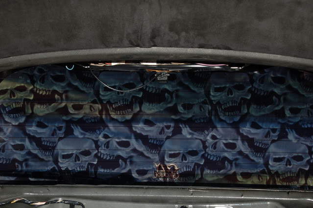

I have my rear window currently Tinted with Skulls window tint, but can really only see it from the Inside looking Out, because the Factory Tint is alread dark.
The eyeball installed on the outside in the Purple would be seen but not as much as if done in White on tinted glass, But still noticable during the day time.
