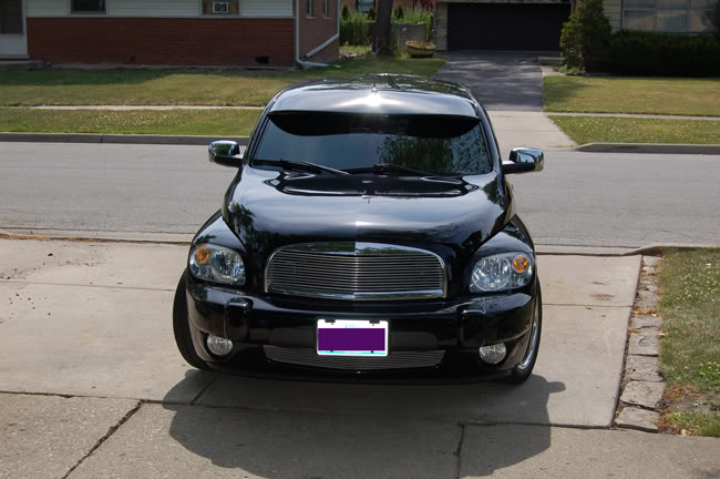

and will do on the pic post! gonna start that project thursday after work and trip to autozone! i think i might get a more vibrant purple from AP's pics i noticed it wasnt as bright as i hoped for. i guess im gonna have to find a gloss purple.. kinda like this..
As I said, it gets Darker the more purple coats you spray on, starts out Alot lighter, I wanted it Dark so I used like 9 coats.
It's sorta like the old school "Candy" color paints with a silver or gold base coat, depending on how the sunlight is hitting it, it looks lighter or darker. The more coats you use the color changes gets darker.
After your base coat is down try two light even coats, see how you like it, add more until desired color is achieved. (Keep track of number of coats you use, and give them all the same.)

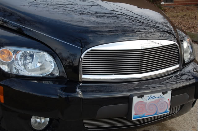

Heres what I did to mine. > https://www.chevyhhr.net/forums/picture-media-11/customized-grille-installed-34139/
Click the Link for more pics and info.

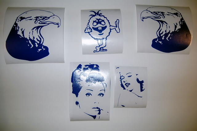

I can make you one if you really want one. Not exact, but close enough.
