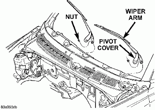

Looking to paint my wiper arms to match vehicle color and get rid of cheap white pepboys type wipers is there a how to...
just wondering is it just one big bolt underneath arm?

Its pretty simple Jeff, just pry up the nut cover at the end of the wiper arm and use a 15mm socket to remove the nut. If the wiper arms don't pull off you might have to use a battery terminal puller, but they usually pop off fairly easily. Here's a diagram that I dug up showing the procedure.

Thanks, that realy helps!!
I did it on my last showcar but that was a supra.
I figured it was similar but wasn't sure.
