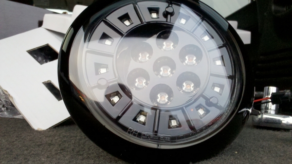

My understanding on the IPCW lights that the backup light has the running light function also but not the brighter brake light function. Someone correct me if I am wrong but I think thats how they work. So only the upper light has running light and brake light function.
Old Mar 3, 2011 | 06:21 PM
Affirmative. This is with the brakes pushed:

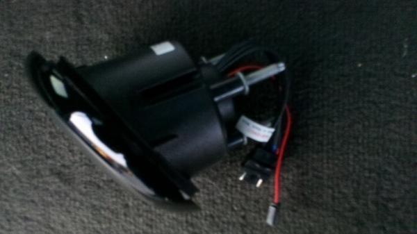

Jason, I hope this helps
Two wires coming out of the back of the IPCW's one for the bulb connection, second for the running light led's. The big one is for the stopping led's and the smaller one is for the running led's. When you go to hook up the IPCW's, all you do with the existing wiring is remove the bulb. Not the light bracket or anything. Then snap them into place, yes for the big ones it can be tough, and remember for all hook ups BLACK TO BLACK. Also, recommend you hold onto the bracket in the back of the light assembly when you pull it out, and insert the IPCW right away, saves a lot of time.
