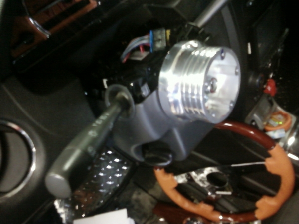

Update!!!!
WOW,,looks like its all gunna work...hub assembled..fits nice..no interferance with stick controlls..good distance..no need for spacer..now yank it all aprt again..(6) times..fasten the wheel and put er all back together..wheel be on tomorrow..im all dun today...

From: Canada
yea lousy cell phone cam..Ill fix that for yas..but sum b$tch..needed a spacer after all..went for a drive didnt feel right..honin out a chunk of aluminum as we speak..inch and a half should do it..got a make it so chica can drive it too...lol
