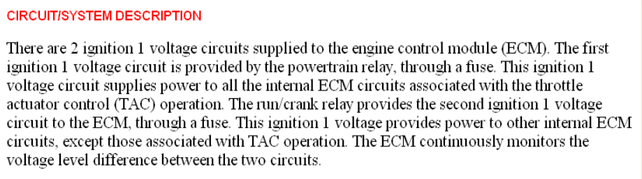

I don't know where that definition for P1682 came from; It is really "Ignition 1 Switch Circuit 2". It means the run/crank relay is shorting or open.
They are all related. I would be suspecting the run/crank relay.
