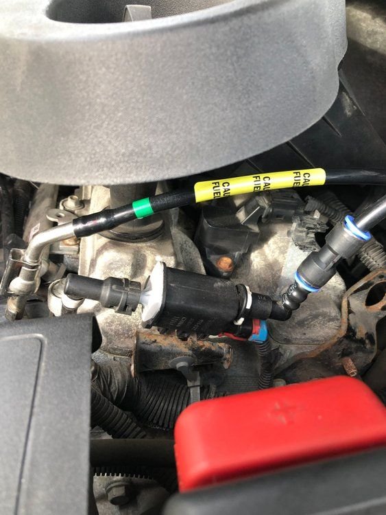

There were no codes at the time I thought of the MAF sensor being faulty was just watching the live data and it seemed to be acting up jumping from .34-.44 LBS/min
But I now my Cat has completed but evap,o2s,HTR are still incomplete and I now have a pending P0446 code. Any advice on this?

Try blowing air thru the under hood EVAP valve, it should be closed. Replace the valve if air does pass thru it.
