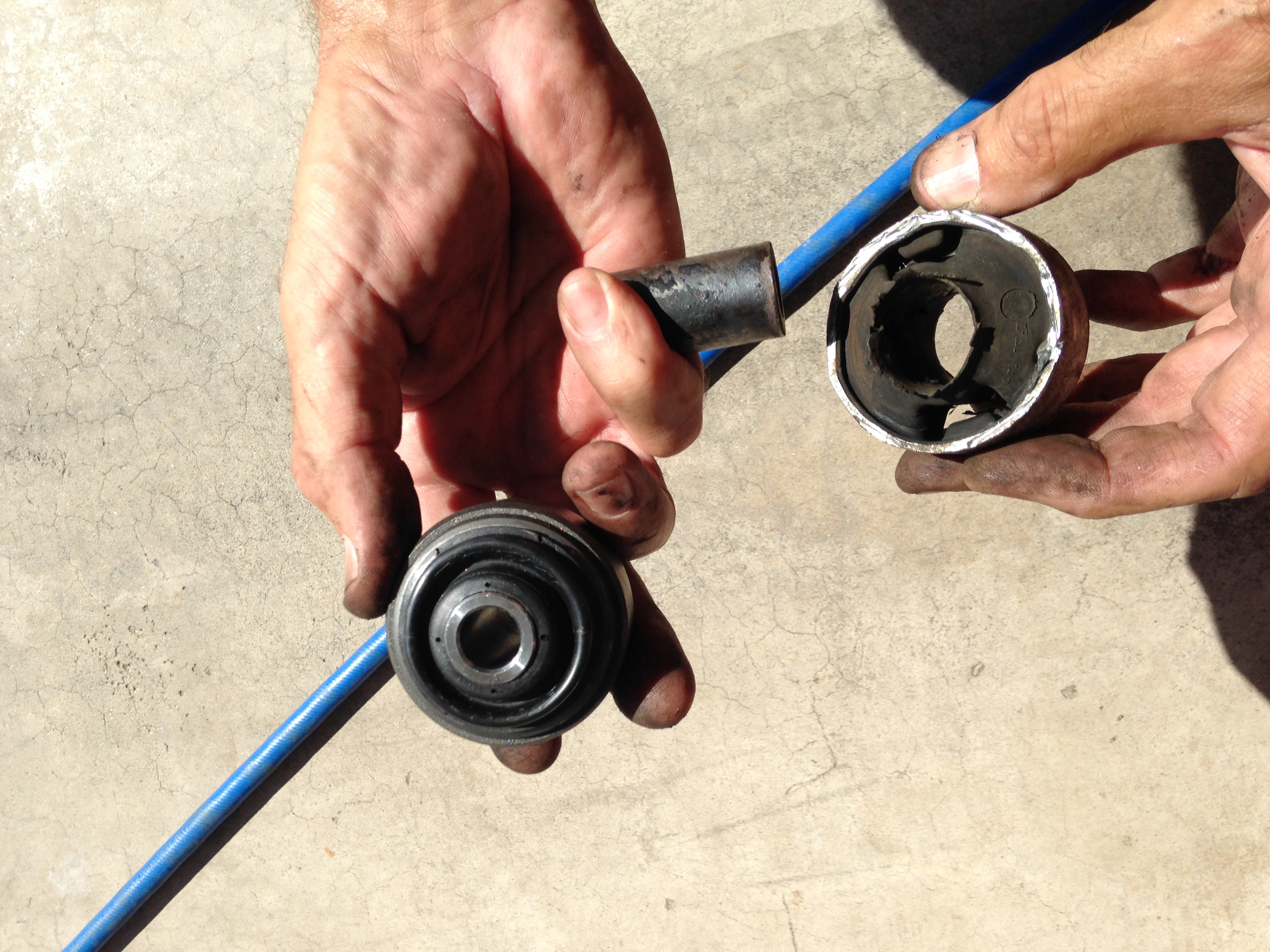

Here you go Don!
It's is the lower control arm rear bushing!
The one on the right is the deteriorated OEM rubber one
The one on the left is a Moog K200792 bearing bushing
The worn bushing allows up to two inches of movement in the front wheel
