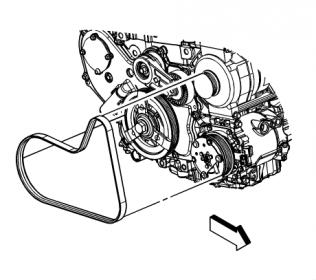

Lastly, you can check for A/C compressor engagement by looking under your HHR. The compressor is located on the front of the engine down low, its under the alternator, you can see it if you squirm under the right front corner. With the engine running, the transmission in park(or neutral if its a 5-speed), the parking brake set, and the wheels blocked, have your assistant push the A/C button. If the compressor is engaging you'll hear a "click" and the end of the compressor pulley will start to rotate. The compressor is the lowest pulley in the diagram.
This is a "look don't touch" area, keep your hands away from all the pulleys while the engine is running.
