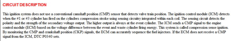

The 2006 2.2L does not have camshaft position sensors, not saying the codes that mention them don't mean something.
Without the codes we can only take wild guesses; mine based on your no start is it was P0016 that was warning that your timing chain was getting ready to break. Or, P0340/P0341 the spark pack may have failed.
