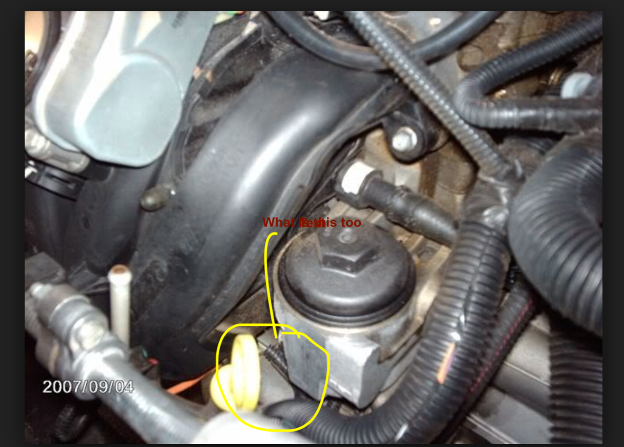

Old Jun 29, 2018 | 08:17 AM
Posts: 26,543
reposted for nistywillow
Cool finally got a chance to get under the hood to check things out y
Sorry about not giving any follow-ups but it been crazy around here and rainy. So, I got to check under the hood this Tues(6/27)and here what I found so far for under the hood.
the first thing is the picture with the cable/connector disconnect from the MAF. and the hose to the air filter did not attach to the side of the vehicle, so I reattached these two things.
Then checking the wire to the starter was fine but I saw a wire just underneath the oil filter either off or broken(which I don't remember seeing it before).
The locks are still intermitting, and power steering /check engine light stays on. Hopefully can get to fix here soon.
Would the MAF(hope that right) being off for that long of time mess everything up?
