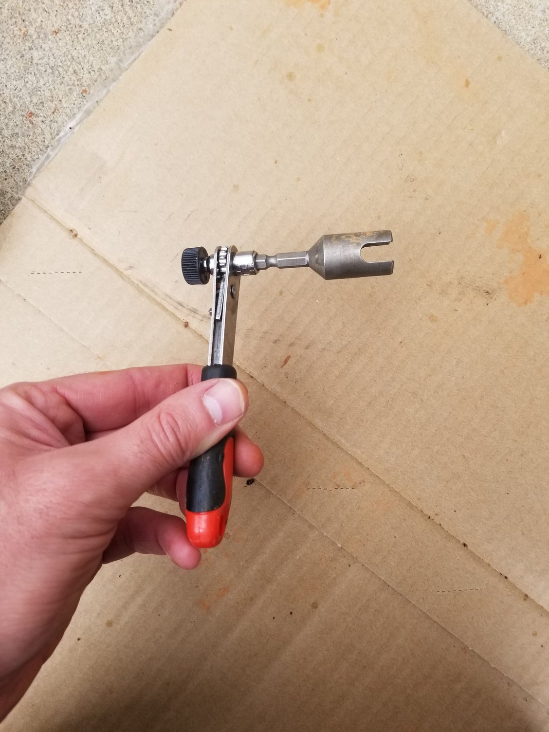

I replaced the thermostat per the instructions on another thread and am currently test driving. Thus far temperatures are roughly 192° +/-2.5°. The HHR definitely seems to be happier.
The attached thingamajig was immensely helpful for carefully opening and closing the petkawk valve.
Thingamajig and a 1/4" ratchet

Neat thingamajig, now burp that baby
https://www.chevyhhr.net/forums/how-...-system-60614/
