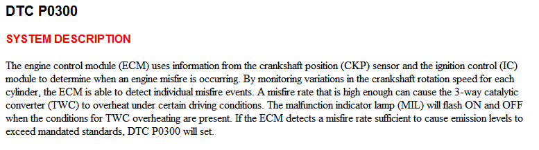

From Mitchell OnDemand:
The IC is peculiar to the 2006. The igniition is a "wasted spark" type where 2 plugs spark each cycle regardless if it is on the power stroke or the exhaust stroke. It sense which one is igniting anything by the resistance of the plug.
The P0300 means The ECM has sensed a condition that is consistent with a misfire, but can't identify which cylinder. NOT random misfire.
This is the reason for relearning crankshaft sensors on new engines, even if you don't get a code.
