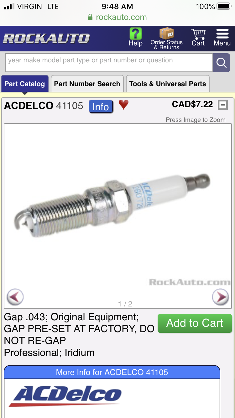

Actually the 41-105 are the correct plug for the 2006 2.2
Yep, there's that "2006 2.2" one-off factor again. Learn something every day... You stop learning, you stop living...

It may show the 41-105 as the plug for the 2006 2.2 but it also shows the 41-103 as a fit also.
Think it's a case of "it fits".
Or one of those "it fits" like the LCA listings on most of the sites that say "fits all". Probably nothing wrong with using the 41-105's. Just a slightly different heat range of plug I'm guessing.
Old Jan 17, 2020 | 01:37 PM
  #27
Posts: 39,997
Oh they fit and work fine, the 41-105 were also the recommended plug for Sweetie’s old 2003 Sunfire GT 2.2, which GM said all came with a 2.4 .
I don’t see the 103’s on this 2.2 listing on RockAuto
https://www.rockauto.com/en/catalog/...park+plug,7212
but they are listed for the 2006 2.4
