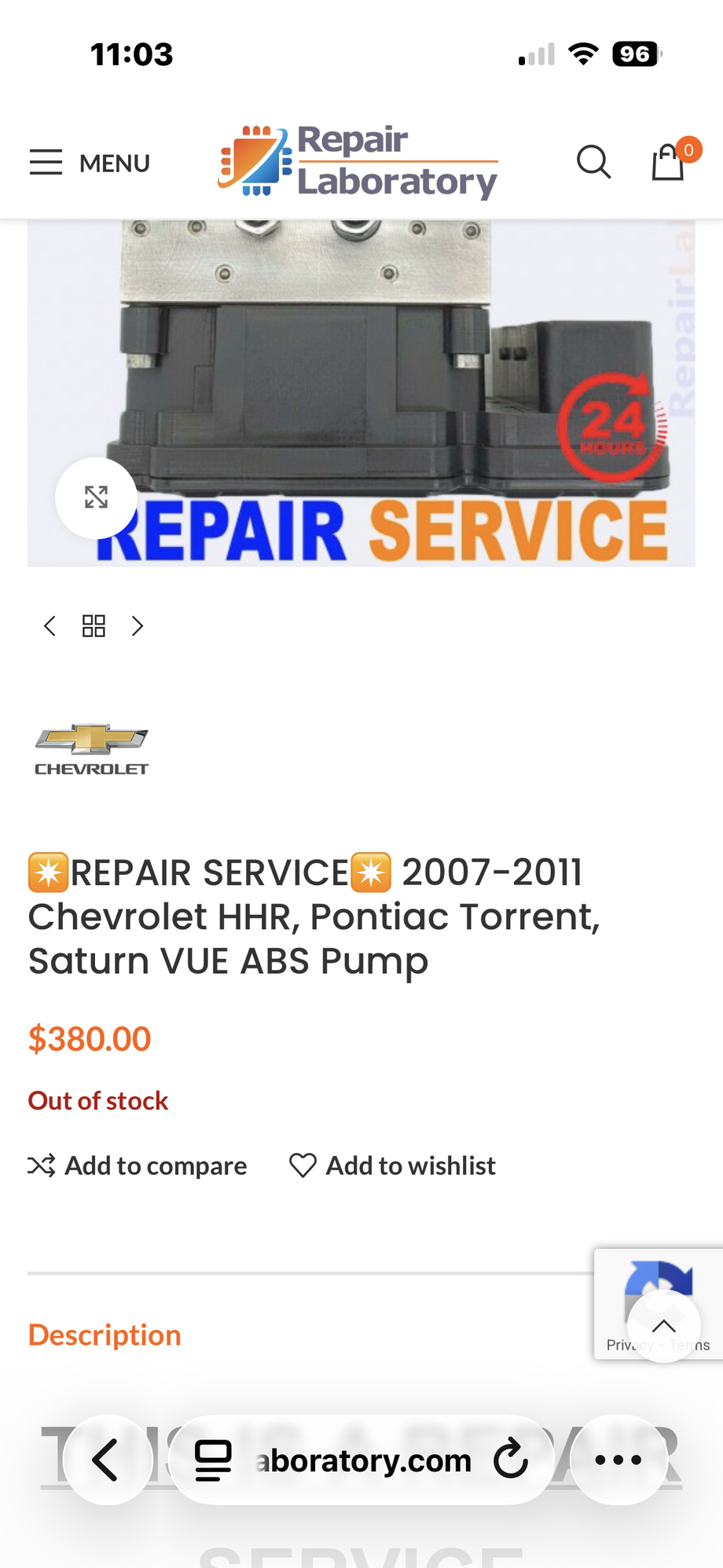

Thanks to you all for your response and help. Just to close this out in case someone else reads this, I did have a bad ABS module. Since Repair Laboratory wanted $600 to repair my ABS module and all of the other companies I tried said they couldn't repair due to a parts shortage, I decided to try my luck at my local junkyard. My first one from the junkyard was also giving me a C0550 error so I was starting to doubt my diagnosis that the module was bad. I mean what are the chances that another one I randomly picked up from the junkyard had the same issue?! Well, I decided to try my luck one more time and picked up two more ABS modules from the junkyard (they were only $15). This time when I installed the first one, I had no C0550 error upon start and was able to easily clear the error codes. My ABS/Brake/ESC lights all went off after I cleared the codes, and I got even luckier and saw no mention of needing to program the unit. The other one I tried said VIN mismatch. We have a lot of snow and ice here now so will take it for more official test drives later, but I believe the C0550 error is gone. Thanks again for everyone's help. :)
