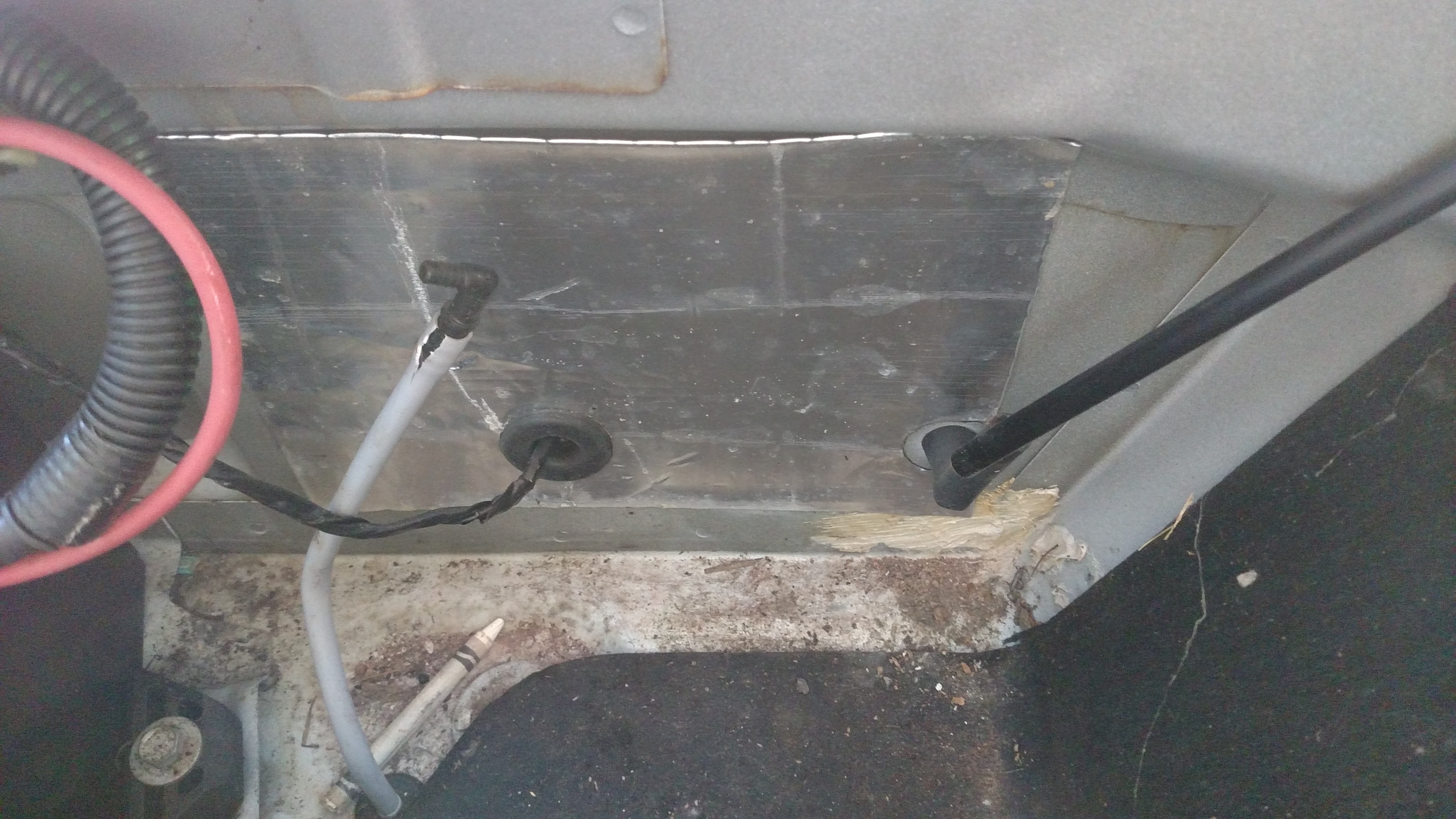

[IMG]hhr battery[/IMG]

picture above is from battery area. battery is good with a date of 06/15
Where does these two hoses connect too?

The gray hose connects to the hole on the side of the battery and the other end goes ot the hole in the floor; it's a vent. That's the only tube I see in the pic.
I suspect the crayon goes into the Crayola box under the front seat.

Double check the ground connection!
Replace the cracked grey tube for the vent

Just checked the battery and there is no place to put the vent hose into.
