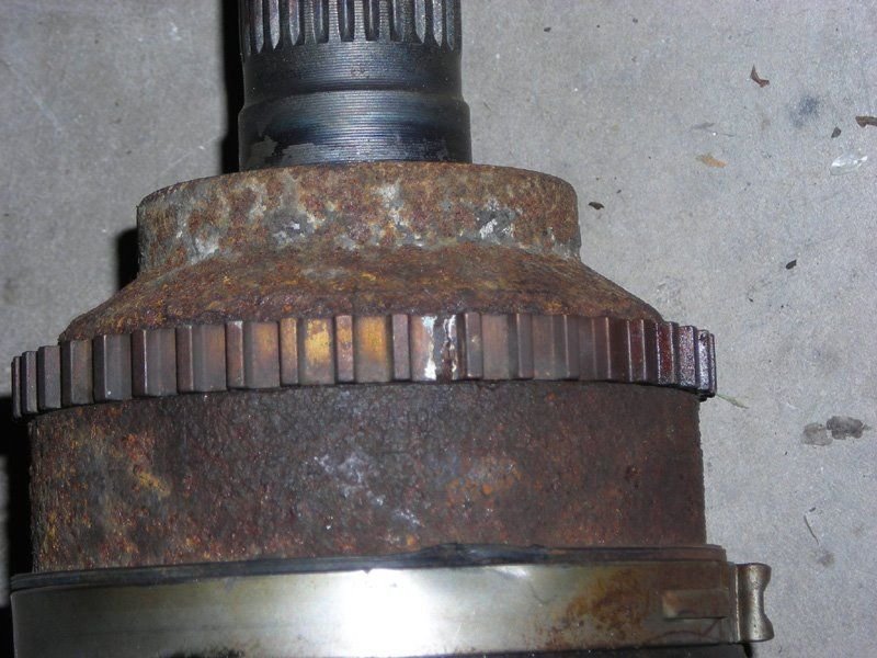

You may have a bad tone ring. These you can spot if you can see them.
This is a broken one here. They do not code all the time.

Posts: 26,533
No tone ring on HHHR.
More likely a transient VVT valve failure..
