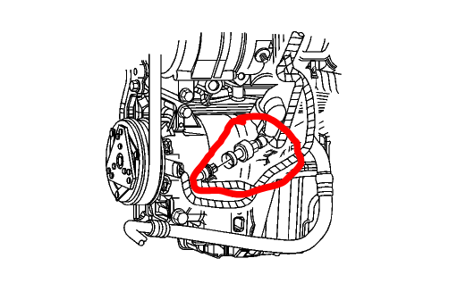

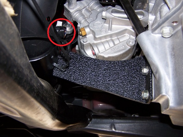

Here's a picture of the compressor. The pressure switch is the silver thing in the side of the red circle.
This is a picture of my SS but the regular HHR's will have the same compressor layout.
