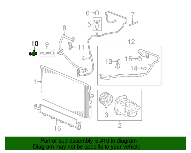

There is a pressure switch on the AC system. If the refrigerant pressure is low, the switch prevents the system from turning on the compressor and fan. The compressor can be damaged if it is run for more than a minute without any refrigerant in the system. The switches have been known to go bad.
According to the Murray catalog this is the switch no 35970.
According to GM parts Direct, this is the location.
The switch is over $30 so I wouldn't just change it to try it. The best way is to check the system low side pressure with ac system gauges. The switch needs a pressure of 51 psi to close. It should be closer to 100 psi when the compressor isn't running. This might be the point to take it to a shop. You have to decide if you want to try to check further.
If I don't have gauges readily available, I disconnect the wiring harness from the switch. It should be a 2 wire connection. Then I use a wire to connect the 2 terminals in the harness. I do it with the engine running and AC on maximum cooling just to see if the compressor turns for ABOUT 15 SECONDS. If the compressor doesn't run, it is a different problem. If the compressor does run and the line that the switch is mounted in gets cooler, there is at least some refrigerant in the system. If it doesn't cool, there may not be any refrigerant left meaning a large leak. The condensers are vulnerable to damage from road debris as there is a hole under the bumper. If the system lost all of it's refrigerant it will need to be put under a vacuum to remove air and any moisture and see if the system holds a vacuum or has a large leak.
If the switch is bad a further test would be to use the jumper wire to run the compressor longer and see if the system cools well. If it does cool well I would try installing a new switch. There is a valve like a tire valve in the line under the switch so it can be unscrewed without losing any freon.
There may not be enough refrigerant to close the switch. Refrigerant can leak slowly from the compressor shaft seals especially in a 10 year old vehicle. As long as there is some pressure, like about 20 psi left, the system is still fairly well sealed and no air or moisture has entered. Refrigerant can be added using one of the kits on the market.
