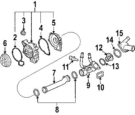

So the thermostat goes spring side up or spring side down? What is the AC Delco part number for the thermostat that I need for a 09 HHR 2.4L?
Old May 22, 2015 | 08:26 PM
  #70
Posts: 11,721
Wow. Sorry, but I'm just speechless that you would ask about the thermostat now after all this.
