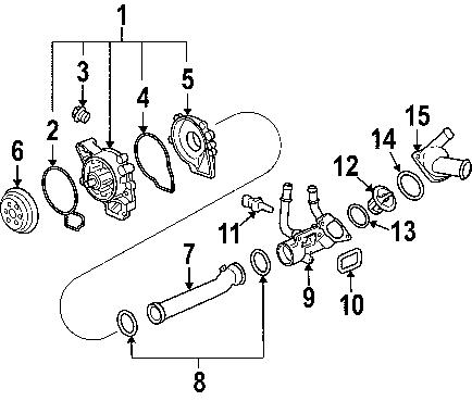

I didn't mean about replacing the thermostat(I have followed this whole thread), I was talking about the "which way" question.
Fwiw. Most thermostats can't be put in upside down. The spring side would not fit all the way inside the thermostat housing cap.
Although, I have seen it tried. Usually leaked or 1 time I even saw a guy snap the housing ear off trying to tighten it down.
What does that have to do with the direction of flow? I was trying to explain my thinking.
The t-stat will only fit one way.
Go to an online site like gmpartsoutlet.net an look for the part, they will give the part number.
I did it for you; they say: 12622410, for a 2009 2.4L, and for that matter all years of 2.2L and 2.4L, that I had time to look at.
