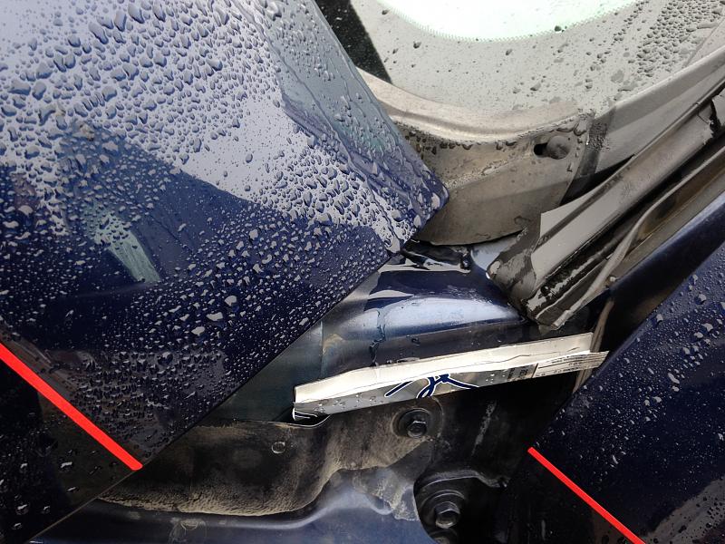

oldblue made a rain gutter for above that boot, maybe he'll post a pic here for you.
Old Jan 5, 2017 | 05:54 PM
Posts: 40,088
Happy to!!
