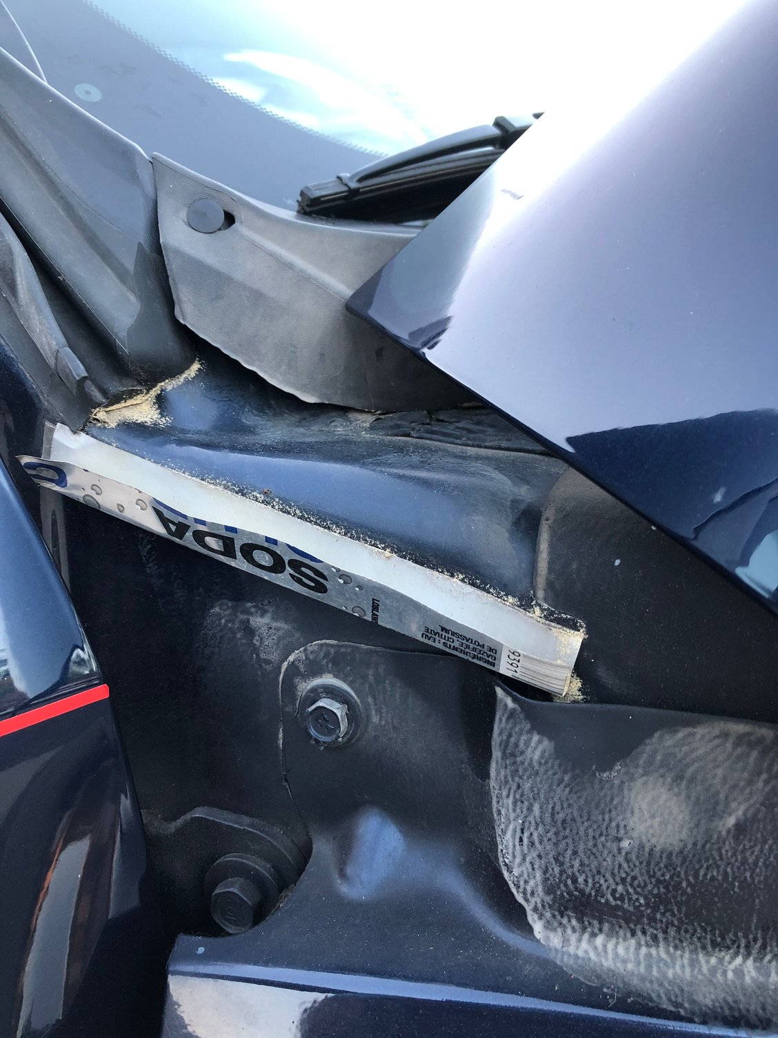

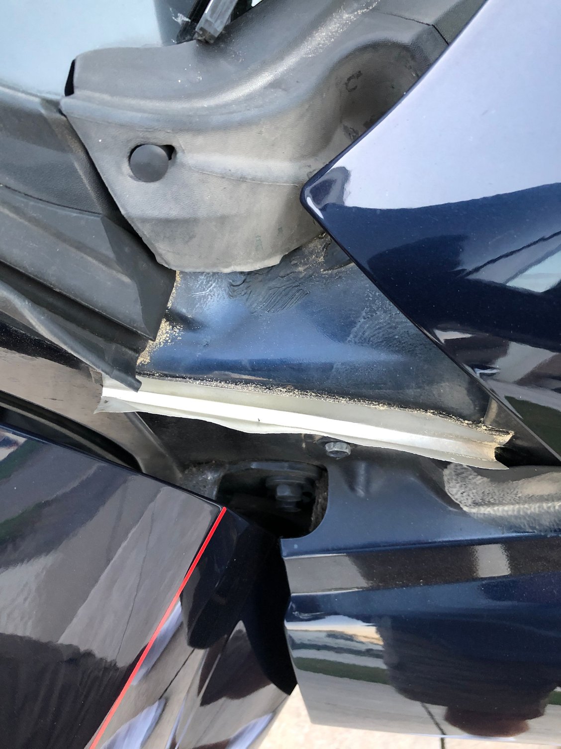

Oldblue, could you show a wider picture of where the drain you made goes? I've already fixed hole under cowl, blown out A/C drain and sunroof drain tube.
Thank you
Old Jun 27, 2019 | 07:47 PM
Posts: 40,090
I bent a flattened out pop can 3/4 x 1/2 x 3/4 , it’s 6” long.
I used 1/2 3M body side moulding double sided tape to adhere them to the body
The back end of drivers side
Passengers side placement
Passengers side
Drivers side
Passengers side
Drivers side
Thank you!!
