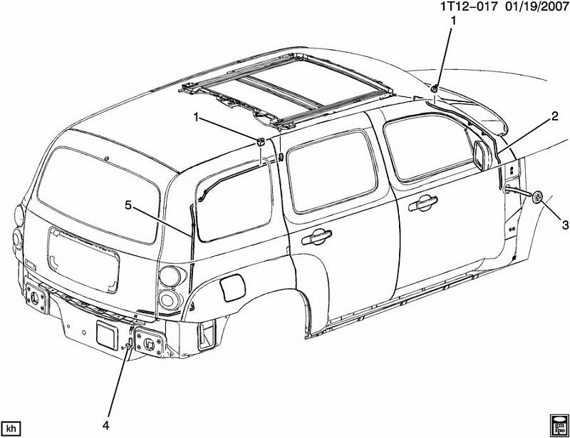

Old Jul 6, 2015 | 08:49 PM
Posts: 11,721
Try this . There are 4 drain points. One in each corner. (other 2 don't show in the diagram )
