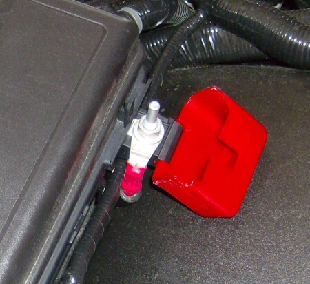

From: Seville. OH
Also check this connection under the hood. It's known to loose up over time.
