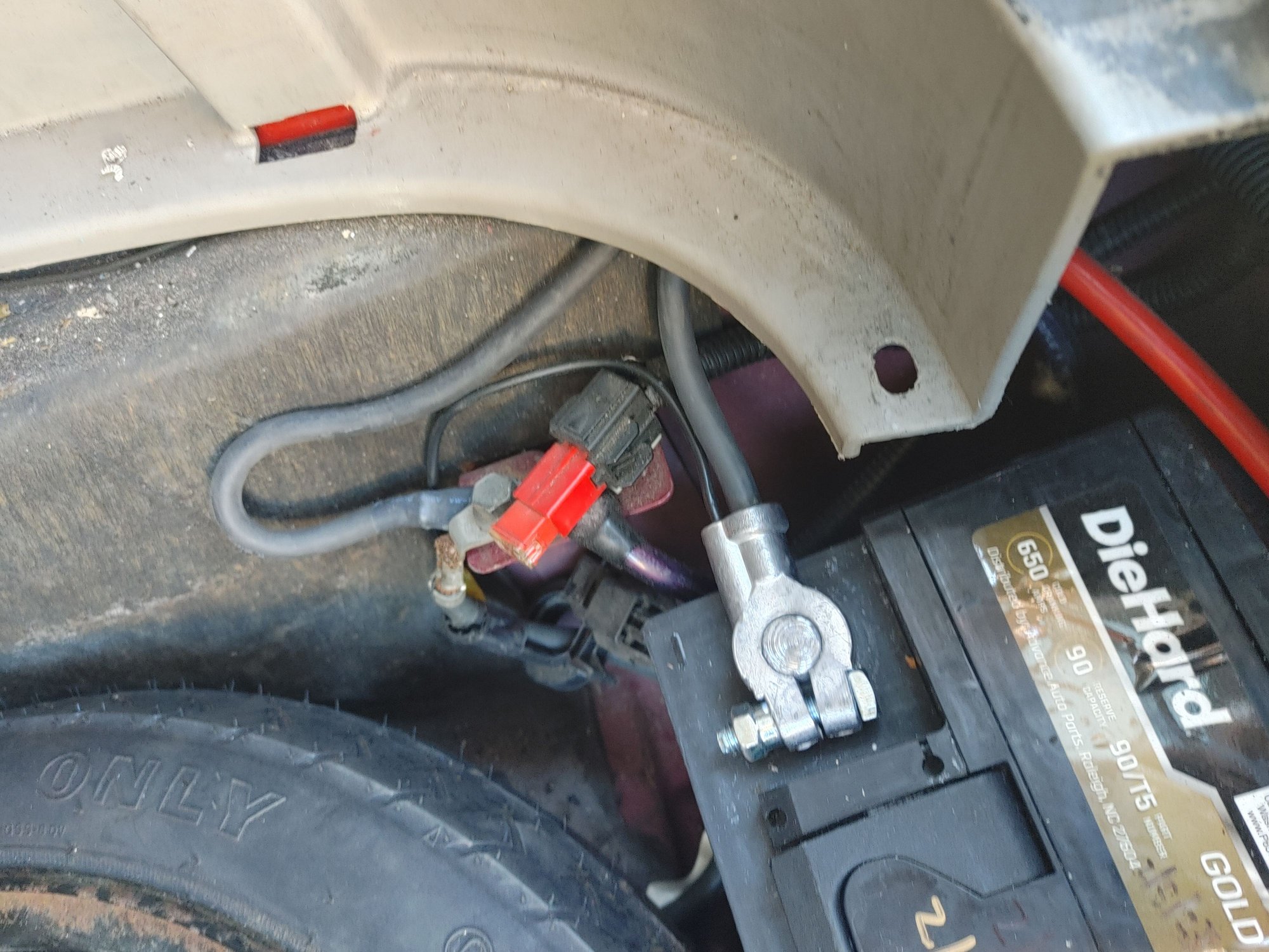

Does anybody know what gauge battery cable we have? I need to install a switch to disconnect my ground until I figure out where the parasitic drain is coming from and I want to use the proper size It will be 4 feet long

Ground wire back by the battery and up under the hood from transmission to rad cradle is 2 gauge copper stranded wire

Thanks for the quick reply I read that iit is 4 gauge but not sure
I was going to hook it to the battery ground, and mount the switch by the right rear back window on the cargo area, then run the ground to the same location as the original next to the battery Just something fast and easy
Right now it is a pain...I have to use a booster pack to unlock the doors and trunk to get to the the battery

My battery was over 3 years old and starting to die, then after I got my new car and stopped driving my HHR every day it died. I checked the parasitic drain and it is high-.25 amps. Supposed to be under .05. So until I figure out why I want to disconnect the battery .
I have a voltmeter and the alternate is charging fine. (It is only a few years old)
I was shocked at the price of cables. I got close to a 50% discount and 2 four foot cables were close to $60 bucks

My rat-rod solution to a battery disconnect switch. Looks like Frankensteins laboratory..lol
I had a new switch for a side mount battery which I adapted along with a piece of 2 x 4. The 2 four foot cables were expensive, probably due to the copper wire. Now I can just unlock the door with the key then reach back and throw the switch. Next step is figuring out what is drawing .25 amps-I will start with checking all the stuff I added to the wiring.
