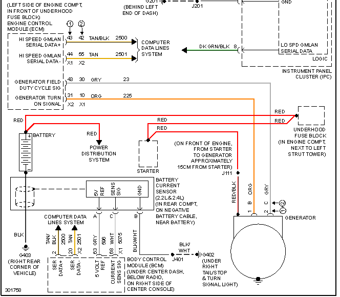

  #29
Posts: 26,539
Lots of people are stuck in the days of a black box that clicks being the regulator. They controlled the output of the generator, now the computer controls the field duty cycle to control how much electricity is produced (current).
BTW, that is why that plastic ring around the negative battery cable is very important; it's the current sensor.
You have to think of the alternator as a motor in reverse. It won't work without a good battery. Some alternator designs include a generator to make the field current so the alternator can function without a battery.
