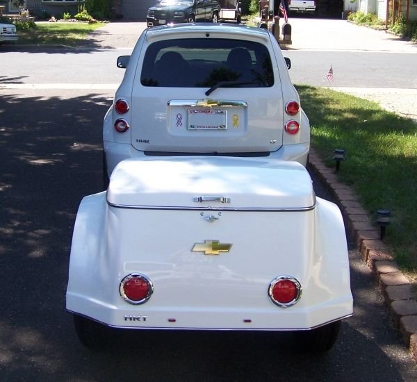

BTW, my daughter's HHR has a badge that says HRT, not HHR. What is the difference?
Old May 21, 2022 | 09:37 PM
Posts: 11,721
No HRT's. They're all HHR's. Either LS,LT or SS.
Sounds like a previous owner changed or modified the original emblem.
Old May 21, 2022 | 09:57 PM
Posts: 11,721
A Google search found this old thread on our site. https://www.chevyhhr.net/forums/appe...er-8976/page3/
One of the pics shows a HRT trailer. May be where the HRT emblem came from ?

The HHR still has OEM HHR badges
Does your daughters HHR look anything like this HHR?
That badge on the trailer looks just like the one on my daughter's car.
