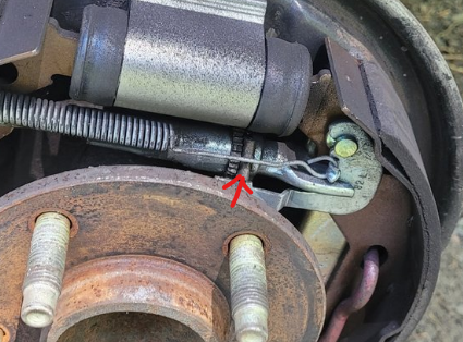

OK, I was able to get the tires off and get a pic of the rear brakes.
It looks lopsided compared to the pic in a previous thread.
D/S Rear Brake
D/S Rear Brake from top
P/S Rear Brake
P/S Rear Brake from top

Old May 23, 2022 | 03:18 PM
  #30
Posts: 26,533
Look like the D/S adjuster might not be contacting the star. The adjusters might be on the wrong sides; from the outside the stars should move the shoes outward when clicked UP, from the backing plate that would be DOWN.
This doesn't look right.
