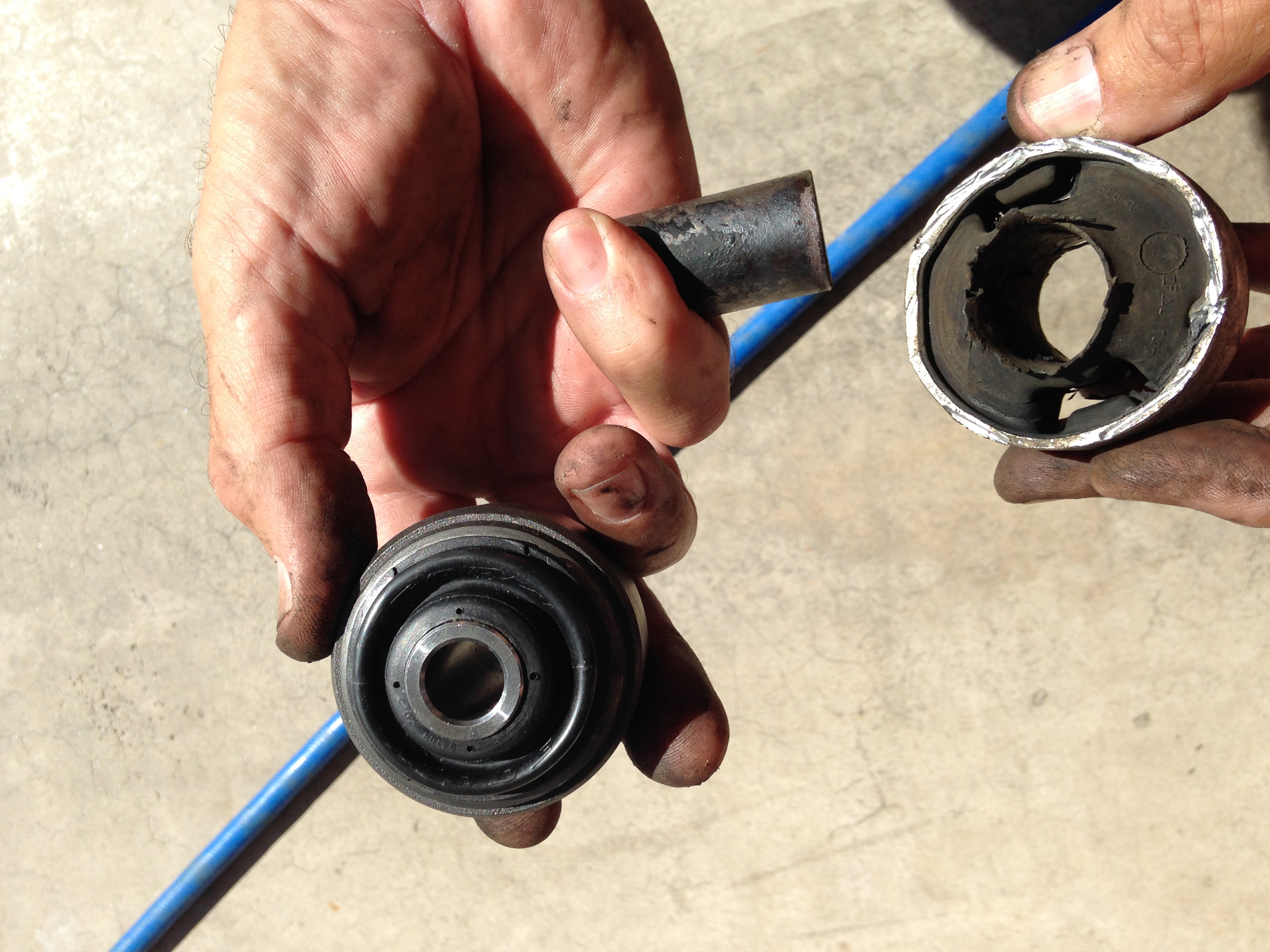

Double check the rear lower control arm bushings, if these are done they will show as a shake under braking.
I have just dealt with this I have the 11.65 inch SS non Brembo rotors and stock LS calipers up front and GM drums and shoes out back. I replaced my LS LCA bushings with K200792 Moog bushing/ bearing, the two piece part on the right is my old GM bushing, 4 years old and about 65,000 miles
