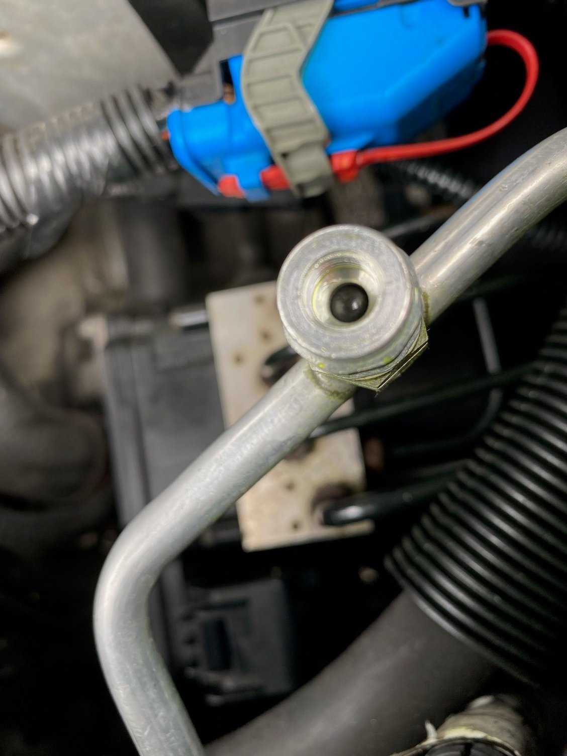

What is the story on the high side A/C Schrader valve?
Here is a picture of the low side which looks like an ordinary Schrader valve that's been used for decades.
Here is a picture of the high side, which does not look like an ordinary Schrader valve. It's some type of rubber thingy. I can depress it. But it does not seal after I serviced the system. Some information on the web indicates it might be one-time-use. Is that true? If so, why did GM use this ridiculous method?

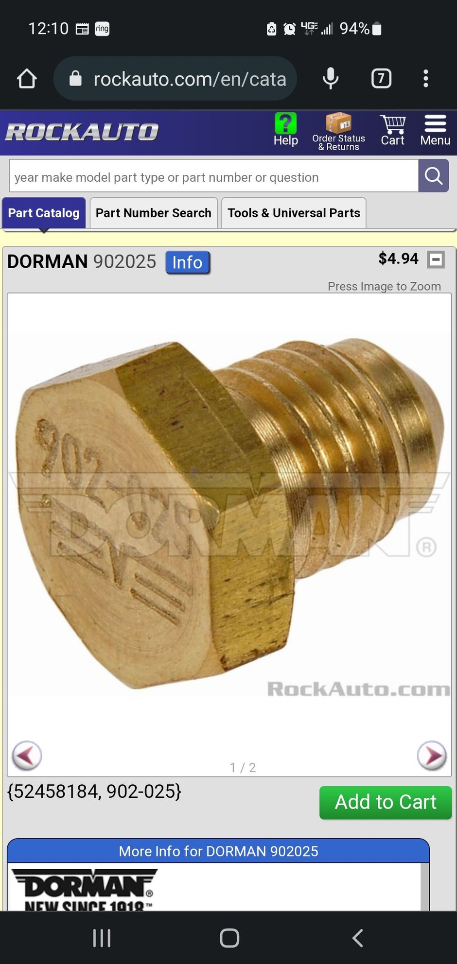

The ball valve has been known to leak. I found this at rockauto.com, might be good for you.
The following image is what I bought. It has an actual Schrader valve, which obviously means the system is repeatedly serviceable.
My main question is why GM used the ball valve? Various web sources indicate it is one-time-use. Obviously, the A/C system gets serviced in its lifetime, so why would it make sense to put a one-time-use valve on its service port? It would be like putting one-time-use valves on tire stems. Dumb!

Just speculating, it may have been that the ball valve was deemed to be safer on the high side. I don’t know enough about it to know whether that’s plausible or not. I think we can safely discount the “one use” idea though, even if plausible that the engineers didn’t care about re-use, as it is successfully reused all the time. And I think that valve was intended to be tightly capped when not in use.

I think we can safely discount the “one use” idea though, ... as it is successfully reused all the time.
I wish you the best of luck next time you have to service your system. I'll bet there's a lackluster 50% chance it works for you. Searches around the web indicate this is a problem on many GM vehicles.
