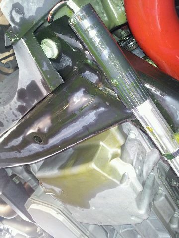

can anyone identify this fluid
Old Sep 11, 2012 | 11:28 PM
foolmoon_design's Avatar
Joined: 05-13-2008
Posts: 2,075
From: Knoxville, TN
Tranny fluid is red, this is not oil. Could it be AC fluid?
it is oily, no grit and yellowish green. ugly, and yes I tasted it. bitter bitter bitter. not dex-cool if it is AC I think the cold-side hard pipe possibly ruptured an AC line. I didn't have time to figure out where it was comming from. Really pissed, as the exterior damage is minimal. I will have a good time cleaning all this crap off when she is fixed got a bad feeling im gonna have T-map issues too. I know power steering fluid is close to this but this is way too far forward in the compartment to be that, brake fluid is close to this color too. Really puzzled

Well it isnt power steering fluid.
I think ac refrigerant is bright yellow/green.

With that taste it isn't coolant so you may be right. Maybe it is car tears.
Old Sep 12, 2012 | 01:02 AM
Looks like A/C fluid, there is a small amount of oil in the A/C system to keep the pump & etc lubed ..
I certainly wouldn't recommend tasting unknown fluids..

Its Ac fluid! lol I change condensers all the time on front end hits on vehicles.

Is your AC working?

Actually, R134a, the refrigerant used in our (and most cars since the 90s) is colorless and odorless. It's the dye they put in it for leak detection that has the color.
