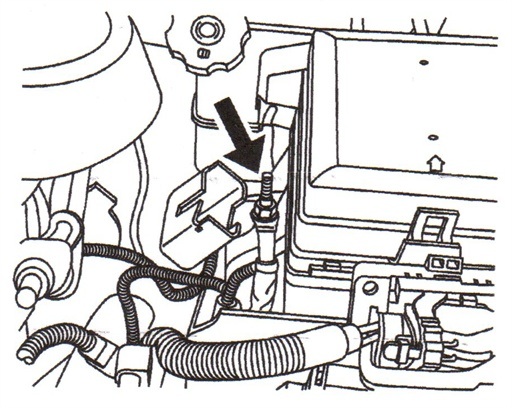

Old Jun 10, 2015 | 06:04 AM
Lucky's Avatar
Joined: 12-24-2007
Posts: 2,873
From: Seville. OH
How about checking the connection at the under hood fuse box. If loose or has a poor connection it can't make an intermittent no crank condition.
