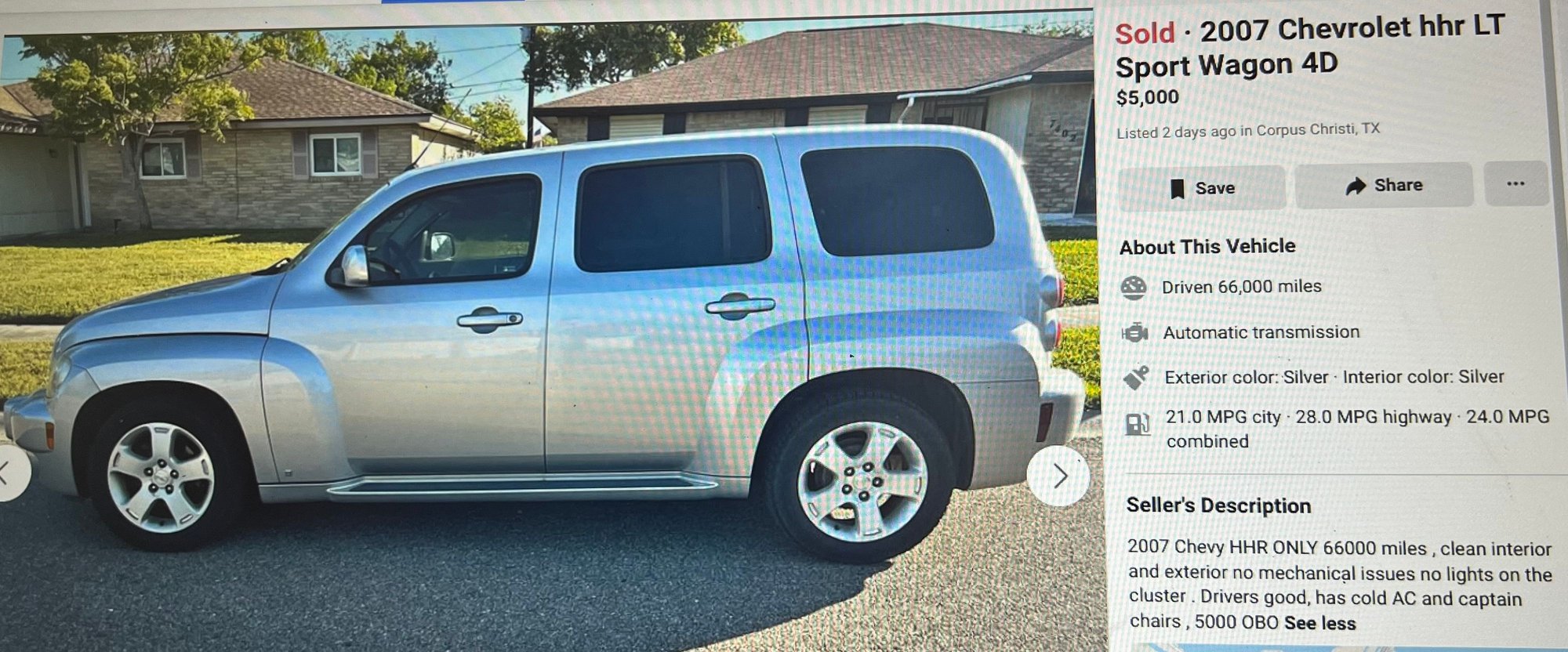

2007, 2.4 liter engine, 66k miles bought this “great deal” no Issues in the 10 miles I test drove before I bought. Engine was smooth , no putting at the exhaust, no cluster lights.
Drive vehicle 30 miles to my house parked for the night , left the next morning and service traction control turned on as I was leaving. Figuring the tires need to be replaced it was a tire sensor. Not even 50 ft CEL came on. Drove to autozone and p300 came up on obd. Parked car and reran codes on a different obd 300& 301 were engaged as well as abs.

Im 97% positive that he cleared the codes. I was able to replicate the first time the codes set.. I drove it 30 miles home turned off engine. Restarted and codes came back. I’m wondering if there might be legal repercussions from him intentionally seeking me a faulty vehicle.

Legal repercussions ? For a 17 year old car that I would guess was sold “As Is” ? If you bought it from an individual then tough luck. If it came from a dealer you may have a 30 day return option.

It’s a deceitful ad. I asked specifically about the engine if there was any work done he said no. I pulled injector one brand new, spark plug brand new, the coil pack brand new. Only cylinder one has been worked on I even swapped injector expecting the misfire to move. Stays on cylinder one But regardless I need to find the issue that is causing this condition to exist . I probably won’t get my money back but by the end I’ll be well versed in the layout of this vehicle.
