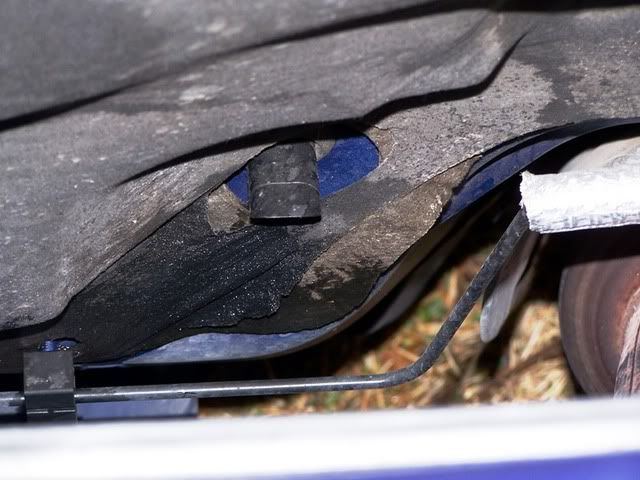

Please check the firewall behind the exhaust manifold, is water dripping out the drain hose?
That’s the hose on the passenger side of the catalytic converter

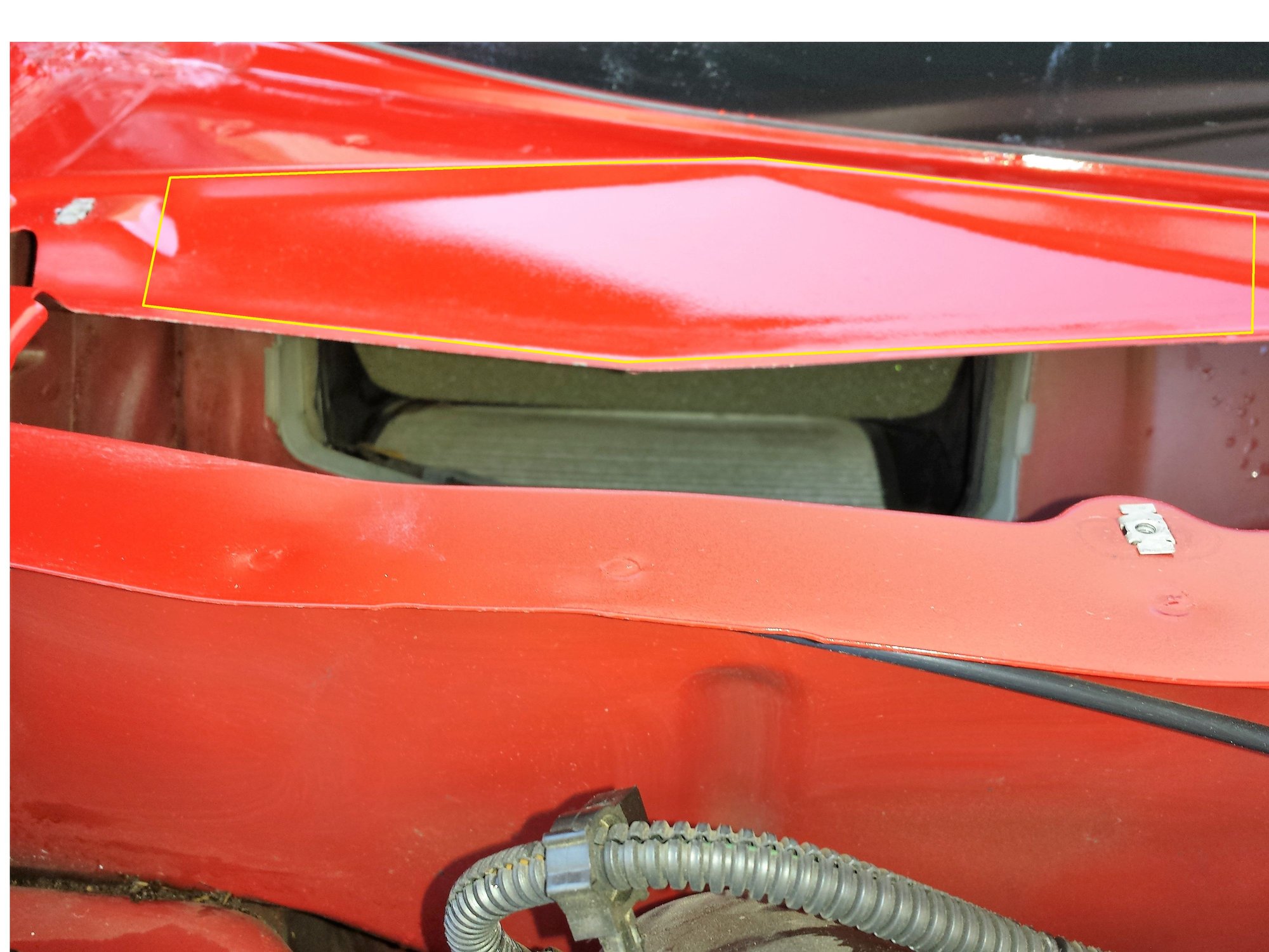

The 07, and later years did not require that patch, the cowl was revised
A 2006 , the patch needs to be replaced
A 2006 with the patch removed
This is a 2010, but the same as 07 thru 11 model years, note the difference in the shape of the holes.
It’s the oval shaped ^^piece
There is a drain hole in there, pull the wiper cowl cover and check it
