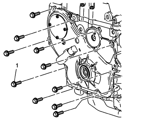

Whats the big drain plug next to crank pulley?

If you mean the oil pressure plunger and spring retainer , it's in the protrusion to the left of the crank seal

I don't know what you mean. The big bump is the oil pressure relief valve.

Oil pressure plunger?

Yes, under the plug is a pressure spring and a plunger
