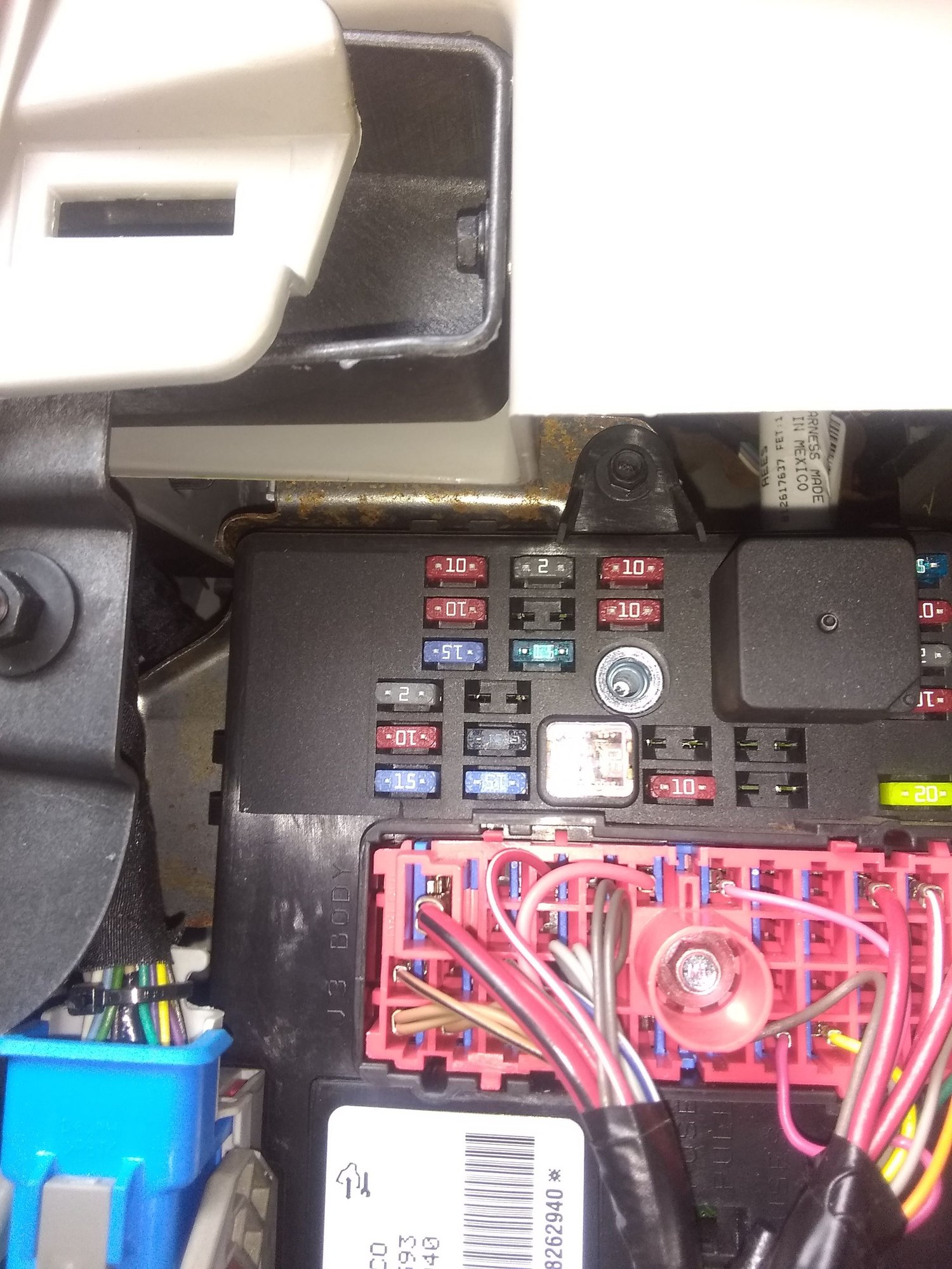

Question Item 32 Where is it
Old May 21, 2019 | 10:05 AM
  #32
Posts: 40,083
The other side of the pinky red connector

Post Please take another look
Item # 32 is notr there. Item 31 is but it is for the HVAC. In the photo this is in rthe upper right hand corner.
Old May 21, 2019 | 05:07 PM
  #34
Posts: 11,721
READ Oldblues post above.
And NOTE 31 and 32 in the diagram show a "broken" line image which means they aren't visible from the outside.
Old May 21, 2019 | 06:57 PM
  #35
Posts: 26,533
Hint: dotted lines indicate not seen in this view.

I inastalled anoher window switch. Still the drivers window will not move. As I have said before I also installed a new motor. I can get he motor to move by appling voltaage directly to the plug. I have no voltage coming out of the switch! I do have voltage on the small wires going to the switch. (Small yellow & Green?)
Again I say I hear something that sounds like a relay when I move the switch in the down and up mode. And the fuses are good Item 17 is the one next to the radio and the fuse under the hood! I am at the end of the road on things to check Is there a fuse behind the RAP ? I will try to send a photo of the back side of the switch to show thew small wires!

I looked at the BCM fuse label and found that fuse #17 is listed as "WNDW RAP". That would affect BOTH front windows.
If you hear something like a relay, that is the motor trying to turn. Something is binding it.
